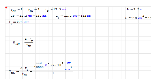

Whenever I add MPa, GPa or even kN/mm^2 SMath seems to introduce the symbol "s" to the equation which looks to be the software changing it back to kg to do the back end calculations which makes sense. It changes it to kg/(m*s^2)
The problem I have is that when I do the 'Optimise = none' to show all of the values for students, it comes up with the base units which confuses a lot of them. Is there any way of assigning the units for these individual values? So only the kg/(m*s^2) shown on the image attached.

Using a custom unit you could accomplish it, although you have to deal with some extra code if you want even the numerical result.
In this example I've added a whitespace at the end of MPa (using CTRL+K), but it might be another character such as zero-width spaces or using an homoglyph instead of a latin letter (f.e. the cyrillic а in place of latin's a)
Thanks David, works perfectly
