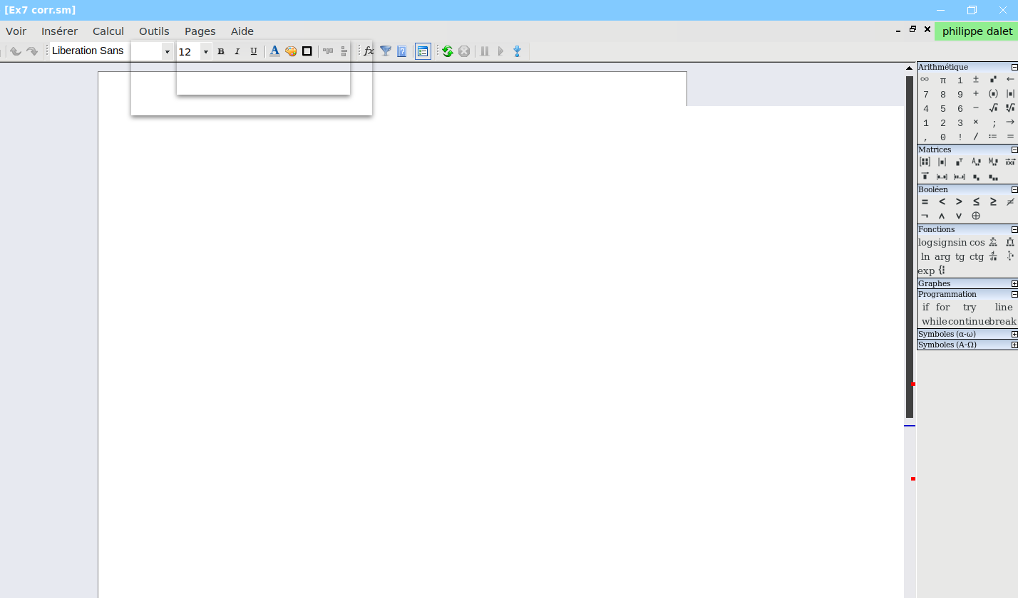

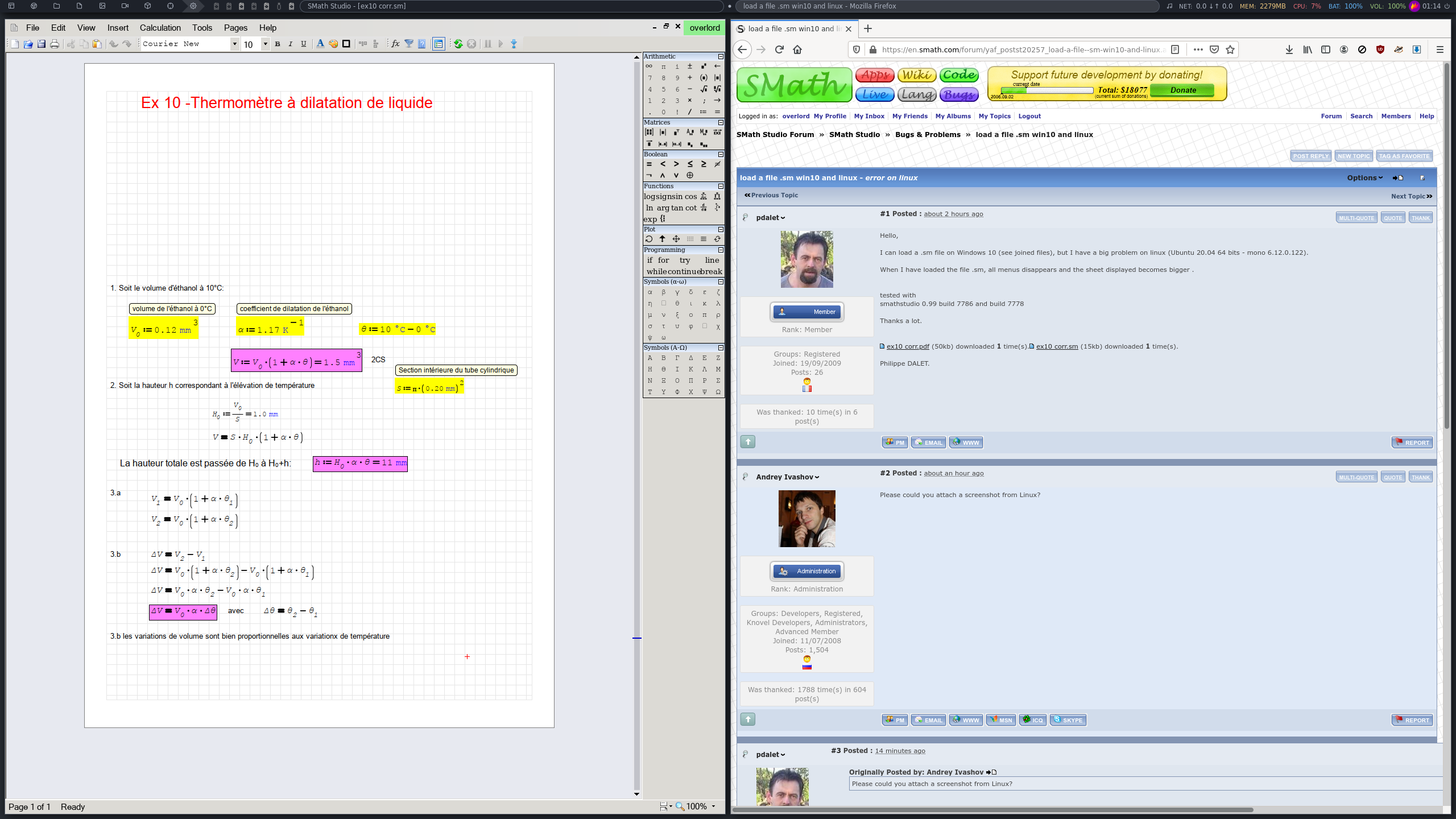

I can load a .sm file on Windows 10 (see joined files), but I have a big problem on linux (Ubuntu 20.04 64 bits - mono 6.12.0.122).
When I have loaded the file .sm, all menus disappears and the sheet displayed becomes bigger .

#2 Posted: 2021/4/26 17:58:07
2,326 likes in 4,013 posts.
Please could you attach a screenshot from Linux?
#3 Posted: 2021/4/26 18:59:21
philippe dalet
philippe dalet
18 likes in 34 posts.
philippe

#4 Posted: 2021/4/26 19:15:06
597 likes in 1,377 posts.
Nothing is wrong with my setup.
Andrey Ivashov 2021/4/26 19:42:00
#5 Posted: 2021/4/26 19:42:52
Thank you. Will check this issue.
#6 Posted: 2021/4/27 05:20:18
philippe dalet
philippe dalet
Hello Andrey ,
I run smathstudio on a terminal and no error messages are displayed in the terminal.

I have done the same operation with SMathStudioDesktop.0_99_7691.Mono.
All is OK. No errors.
