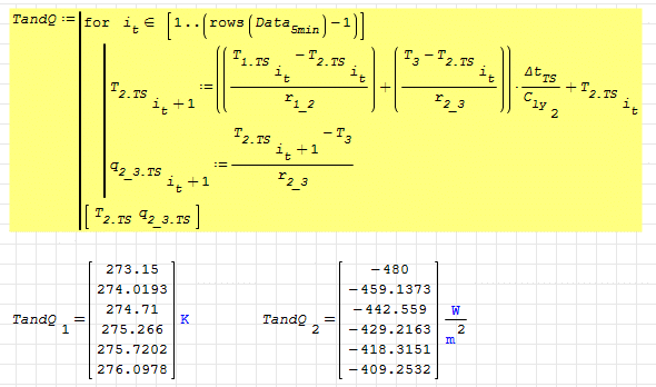

I've tried CTRL+A and changing the optimization from symbolic to numeric on this sheet already, it did not help with my calculation run time. I'm hoping somebody can lead me in the right direction!
I've highlighted the loop that I'm trying to calculate.
I also tried running the sheet without any units and it took under a second to calculate. Is it normal for SMath to perform this way?

Hi. Check Delta_t.TS please.

You can enrich the project from the very beginning.
Page24 Enrich Project.sm (23.59 KiB)已下载 1374 次。

The attached project was completed in collaboration.with the Originator.
Very closely related to yours. Superb model fit c/w its inverse/solve.
Inst_Thermal Insulation Copy.sm (127.36 KiB)已下载 1136 次。
