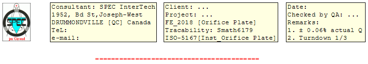

WroteAs far as I can tell, whenever the page printable area is reduced it also reduces the background image size (which I was trying to use as a header)
This a generalized/personalized Cartouche. Little modifications will make for my all project.
Some project will have 100's Instrument Spec Sheets, [Temperature, Pressure, Flow, Valves ...]
With a bit of patience they can be resumed in Data Table c/w more pertaining information(s).
This last type of document [Data Table] is so huge that it was done on Drawing size.
Thanks for this .. but this is simply images on the first page, right ?
The aim is to have a header, ideally 'pre-populated', at the top of every page.
Thanks, Geoff
Thanks, Geoff
WroteThanks for this .. but this is simply images on the first page, right ?
Two things:
1. The logo is an image, i.e: your Company Logo but the text is as per project.
2. The header is roughly from Windows and in Smath can't be redesigned.
You would need a plugin, completely useless as you just have to use your template
for each documents. I have recollection some Engineering firm using such
model template, for their Mathcad documents purported to Clients.
