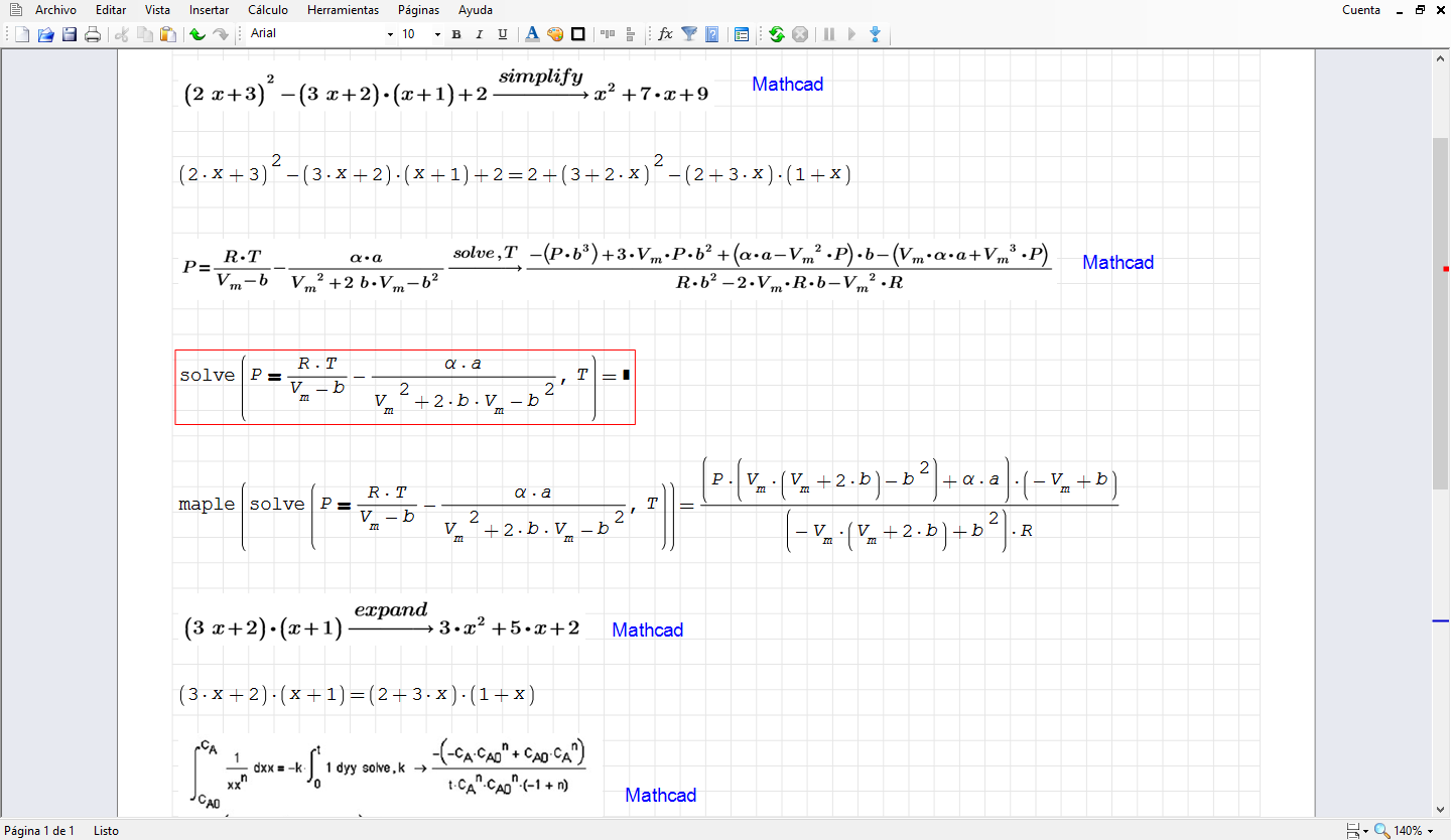

How can I do a symbolic resolution in SMath-Studio?
In mathcad there are: simplify, expand, substitute, etc.
When I solve an equation, I have to use "maple". Can this be done without using it?
Mathcad to SMath Studio.sm (103.48 KiB)已下载 1368 次。

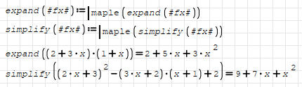

Maple and Maxima plugins has symbolic simplify functions.
Unfortunately SMath don't have this features natively.

You can write your own functions to make expand(),simplify() work as if they are implemented.
Don't sure if they will work with complicated function, but they are fine with simple ones.
