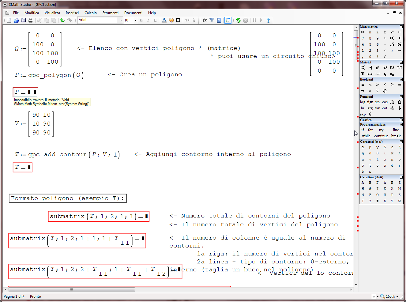

the plugin provided for the double chance (as can be seen in the upper left of my screenshot) but at the moment with the updated smath version (7219), does not work.
WroteThe plugin GPC Wrapper seems it does not work with build 7219
Fixed for latest available Nightly Build (0.99.7250)
