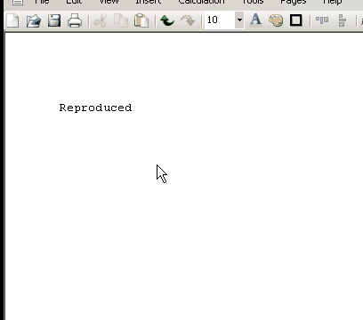

Seem it's not possible to use the product(#,#,#,#) function when you type on the canvas: product(
No issues from Dynamic assistance and Functions Toolbox.
Can someone confirm this?

Hello w3b5urf3r,
Confirmed.
I remember that kind of bugs has been reported before (see mess on the screen, for instance). By the way, sometimes is hard to find out if the bug has been already reported or not, although we could be quite sure that it actually was. Nevertheless, we can reported them again/
Confirmed.

Thank you! Fixed.
SMath Studio supports this function only for drawing, but not calculating.
Wrotethe function int(2) exist but it's not visible in the dynamic assistance
