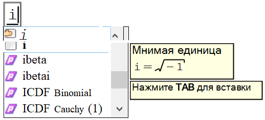

#1 Posted: 2023/5/28 13:35:26
Valery Ochkov
Valery Ochkov
66 likes in 682 posts.
We need the i variable as variable but not as sqrt(-1)

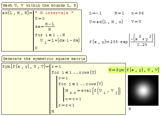

#5 Posted: 2023/5/31 14:24:36
Your Tij make Trc ['r' row ... 'c' col]
Valery Ochkov 2023/5/31 15:02:00
#6 Posted: 2023/6/1 12:59:37
That's what I meant. If the function generates complex
'i' could not be used as index.

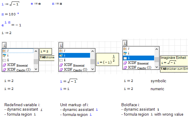

#9 Posted: 2023/6/2 12:14:04
1,353 likes in 2,264 posts.
A consistent way to define mathematical (and perhaps immutable) constants would be to mark them as units. In the case of e this would collide with the elementary charge but for i and pi this might work.
Yet this would require changes in the core of SMath, but part of the expected functionality could be provided by custom units.
There are some glitches in the dynamic assistant though:
- Original definition of i is displayed even though it is not available any more. This can be potentially dangerous
- Re-defined variable i is shown in the preview as we would like to see it in the sheet, yet in the sheet it is not italic.
imag.sm (27.83 KiB) downloaded 1329 time(s).
