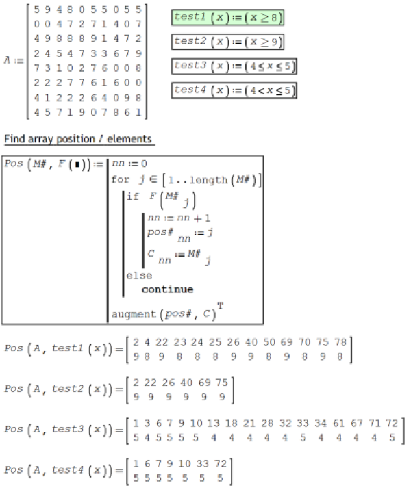

How do I find all rows of a matrix M where column n contains all numbers ≤ x.
I cannot figure out how to use findrows for this. If my text expression is max(M) it works fine, but
the ≤ test does not work for me.
An example would be much appreciated.

#3 已发布: 2023/6/26 17:24:48
1,139个赞,共1,805个帖子。
Hi. This is an option.
MFind.sm (14.22 KiB)已下载 1545 次。
MFind.pdf (58.83 KiB)已下载 977 次。

#5 已发布: 2023/6/27 12:13:11
NDTM Amarasekera
NDTM Amarasekera
130个赞,共352个帖子。
Another method
Array_Pos.sm (14.76 KiB)已下载 1457 次。
#6 已发布: 2023/6/27 14:51:06
RegRetired
RegRetired
8个赞,共144个帖子。
Ndtma,
Thanks; however, I don’t understand the large numbers in your answer, which are greater than the size of the matrix.
Sorry for my lack of understanding.
Reg CurryLoveland, CO
#7 已发布: 2023/6/27 16:48:45
1,443个赞,共2,936个帖子。
Ndtma,
It's the item position by linear indexing. Elements can be accessed using a single index, that is the position sorted by rows (base 1). f.e. The 2nd element in the 3rd row is indexed (3-1)*cols(matrix)+2

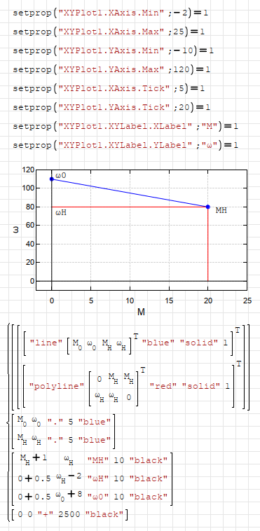

#8 已发布: 2023/6/27 17:41:12
RegRetired
RegRetired
8个赞,共144个帖子。
Okay, thanks. More complicated than I was looking for. My matrix is 2000x2. But, the responses gave me a clue on how to write my own that is similar to the MATHCAD match function.

I am gradually becoming accustomed to SMATH. I do have one more question on plots. If I click in an XY plot to change some formatting and I accidentally hit my mouse wheel, the plot changes the zoom level. It’s not obvious how to return to the original view. If I close the file and reopen, it is back to normal. At first I thought this was a bug, but searching the forum, I see it is a feature. Is there a simple way to return to the original view when I accidentally move my mouse wheel.

#9 已发布: 2023/6/27 18:16:02
983个赞,共6,866个帖子。
I am gradually becoming accustomed to SMATH.I do have one more question on plots.If I click in an XY plot to change some formatting and I accidentally hit my mouse wheel, the plot changes the zoom level.It’s not obvious how to return to the original view.If I close the file and reopen, it is back to normal.At first I thought this was a bug, but searching the forum, I see it is a feature.Is there a simple way to return to the original view when I accidentally move my mouse wheel.
I mentioned that before, about your spoiled X_Y plot
f(x), data ... quick plot is insensitive to command wrt the graph plot.
Differently the X_Y plot will scrap the limits if you slide the graph.
Never put the mouse in the X_Y plot. Resize [X,Y] from the system.
#10 已发布: 2023/6/27 18:53:46
600个赞,共1,381个帖子。
Thanks again.
You can try to learn setprop() function for X-Y Plot.
https://en.smath.com/forum/yaf_postst1774_X-Y-Plot-Region.aspx
https://en.smath.com/forum/yaf_postsm59088_X-Y-Plot-Region.aspx#post59088
Here is a simple demonstration I posted before.
DPT_NV plot.sm (20.47 KiB)已下载 1531 次。
#11 已发布: 2023/6/27 19:42:06
RegRetired
RegRetired
8个赞,共144个帖子。
Thanks. Very helpful!
