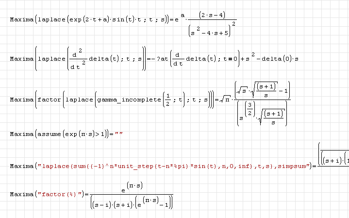

You might try the Maxima plugin. Maxima is free and open source. I tried to reproduce some of the handbook examples.
