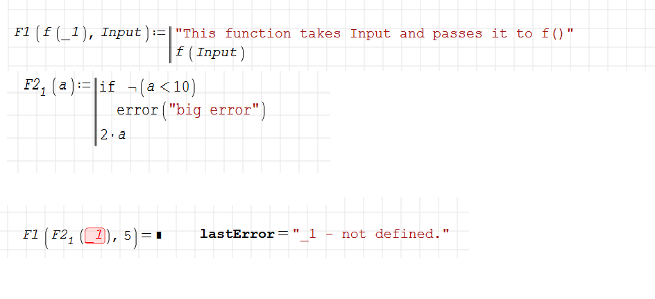

I am having some strange issues with cases/if statements that contain variables in the condition in addition to error() function in the result.
The issue only arises when the if/cases statements are in a function that is passed into another function. See attached.
Any thoughts?
variablesInConditions.sm (14.62 KiB)已下载 1696 次。
variablesInConditions.pdf (88.21 KiB)已下载 921 次。

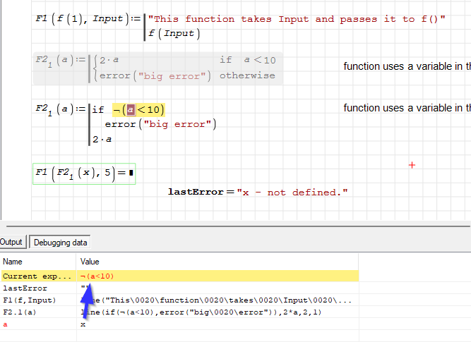

Thanks for the explanation. I think I understand why cases(...) will not work. But I still receive a strange error when using if(...). Is this also expected?
variablesInConditions.sm (15.05 KiB)已下载 1689 次。
#8 已发布: 2023/6/23 10:33:15
1,443个赞,共2,936个帖子。
Hi, sorry the late answer!
Yes, altough I'm not sure if could be improved by Andrey somehow.
With some slight modifications on the names, you can see more clearly that the error is generated on the F1(2) preprocessing. Here x is passed as input to the first argument and if() fires the error.

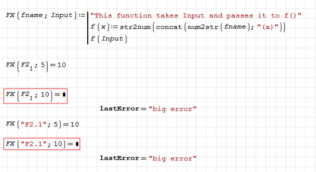

The only alternative that comes to my mind right now is the one below. You have to pass the function name rather than the function itself.
It is a workaround, and if you pass it as a variable, the variable itself must be not defined.
