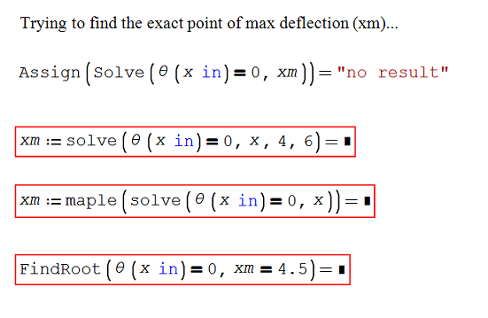

Here is a problem I found trying to solve a simple engineering question.
Please see attached file: Problem with solvers.sm (90 KiB)已下载 1435 次。

Equations are solved with FindRoot().
I also had to make some alterations.
Original y(x) function has unit mismatch.
Solvers don't like direct usage of if() or cases().
You can detect it with Unknowns().
If it doesn't produce a result, there is a problem.
Here is your file solved.
Problem with solvers_solved.sm (95.81 KiB)已下载 1438 次。

I assumed C.1 and C.2 has same units.
Maybe I was wrong at that conclusion.
Worksheet below find a solution between 4-6.
This may be the correct result.
Sorry if I made a huge mistake.
Problem with solvers_revisited.sm (105.7 KiB)已下载 1525 次。

Perfect! Thanks for your cooperation!
