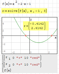

#8 Posted: 2015/12/12 01:35:37
Your function has root = 1
Always plot before solving
"solve" for a single function is implicit of solving for the roots
so, your solve block is ill conditionned.
"Assign" ... Assign what ?
here is an example of good use.

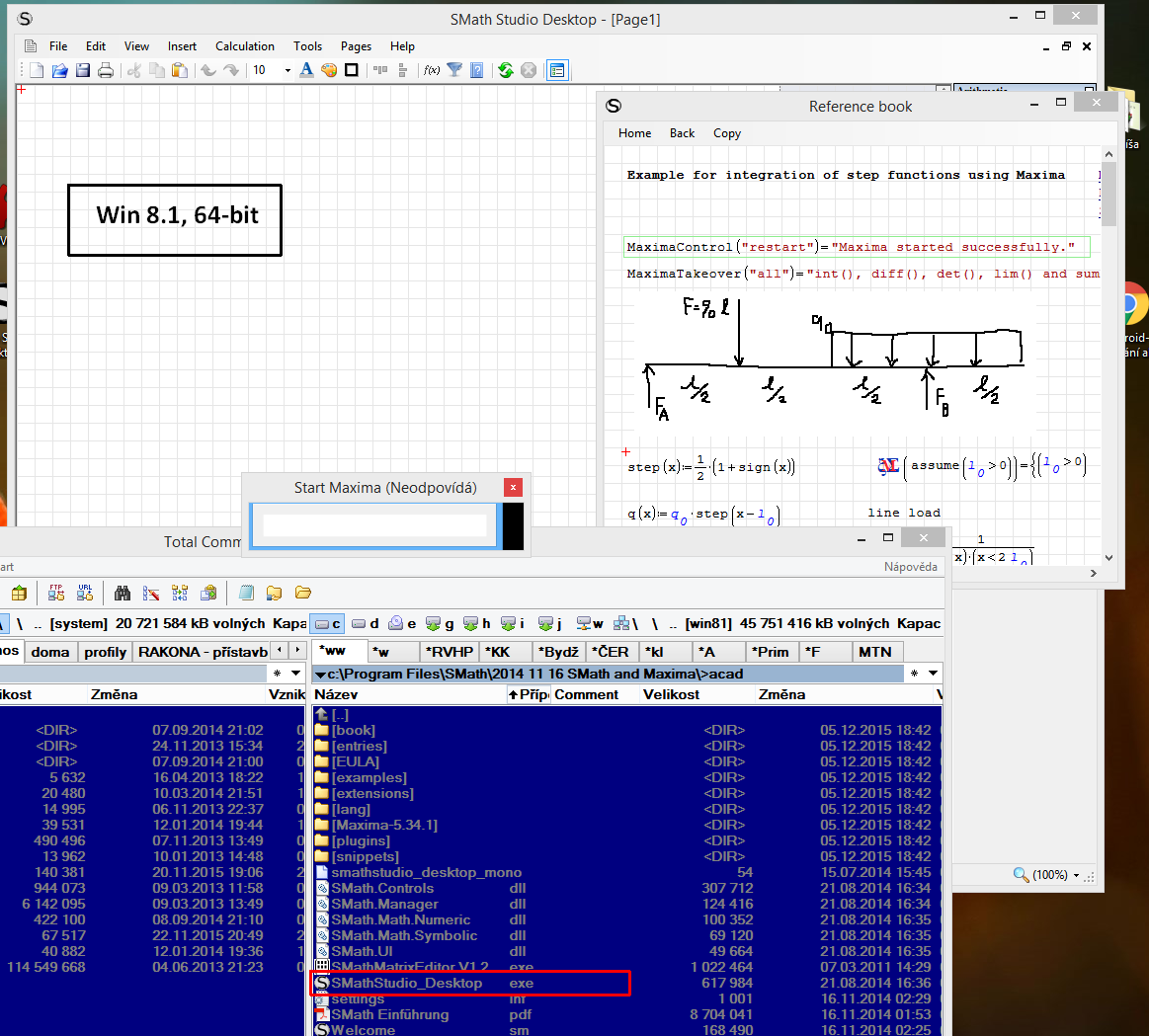

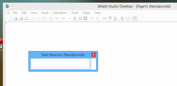

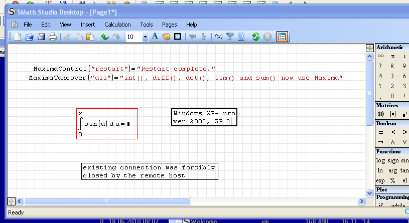

I tried to run portable with maxima on w7, w8 -- collapsed
and on w xp -- I could Takeover, but I could not evaluate int() function.
Sorry. I solved my problem using maple() function. It is not so nice ...

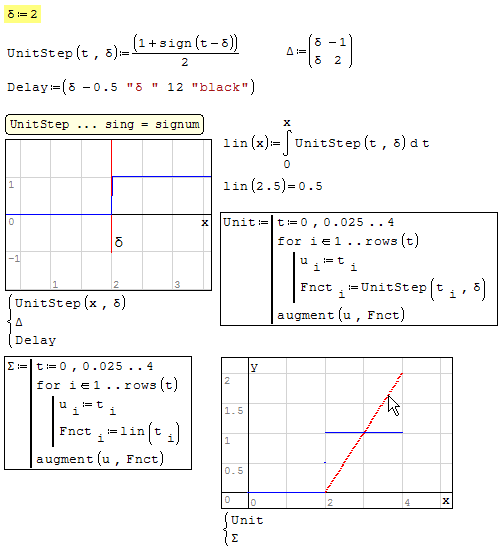

Honestly: I wonder why some Smath users pesist with Maxima ?
done XP [SP 3], just Smath

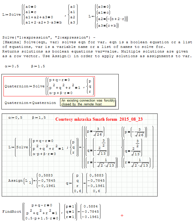

Sorry. with maple it works. Smath doesn't load the Maxima Plug-In on my Windows10 system when i use Solve(). If i assign Smath the Maxima.bat i get an error report.
#15 Posted: 2016/11/3 11:16:18
Sorry. with maple it works. Smath doesn't load the Maxima Plug-In on my Windows10 system when I use Solve(). If i assign Smath the Maxima.bat i get an error report.
If you are new to a CAS [Computer Algebra System] like Smath or Mathcad per say,
you will suffer getting used to what works simply and what does not work "simply".
The Smath [Maxima] "Solve" is recurrent/circular/never been answered properly.
My conclusion from observation is that Smath designers have permission to access
"Maxima Solve", but that permission is not distributed with the public release
of Smath ... "An existing connection was forcibly closed by the remote host"
!!!!! forcibly !!!!!
In this snippet, Martin Kraska had permission for the 'Quaternion' but not me "forcibly"
For me, it does Solve the top system as a "Maxima gratification" but then forcibly rejected. In other words "not public". Alternately, you can use "FindRoot".
Be careful: setup the system in lexicographic order. Quaternion has two expansions
because of ^2. FindRoot is numeric only and you don't know which one is which.
FindRoot is very dependent of the initials.
Solve at "Maxima home" does probably solve symbolic for $ then zap Smath.
AFAIK, Mathcad Prime use "Maxima" for $ and probably solves "Quaternion" properly.
If not: Mathcad Prime => piece of crap vs Mathcad mathsoft.
