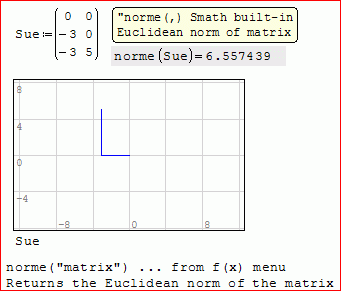

The question is like this: Sue walks 3 metres to the east, and then 5 metres to the north. What is Sue's displacement from her starting point?
The length of a vector can be computated with the euclidean norm (wikipedia); do it for each vector you have, sum the results and you have the total displacement.
How would I plot those two vectors in SMath? How would I then draw a diagonal line connecting the ends of those two vectors in order to calculate Sue's displacement from her starting point?
In a standard plot (type @ on the canvas) you can draw segments using matrices (x coordinates on the 1st column, y coordinates on the 2nd column); a path can be drawn with a single matrix or grouping single vectors with the sys() function (last element in the "Functions" panel on the right of your screen)

Did Sue walked 3+5 = 8 meters ?
What is "displacement" in math/physics terms ?

Sue walked 3 metres + 5 metres for a total distance traveled of 8 metres.
"Displacement" in maths/physics terms is the distance from the point of origin. If you are in place x and you walk 3 metres to the east and then 5 metres in the north and you are now in place y, as per your attached graphic, you are at a displacement from place x of about 6.56 metres as that is the distance as the bird flies from place x to place y. Thanks for that graphic, it will help me learn how to do this in SMath.
