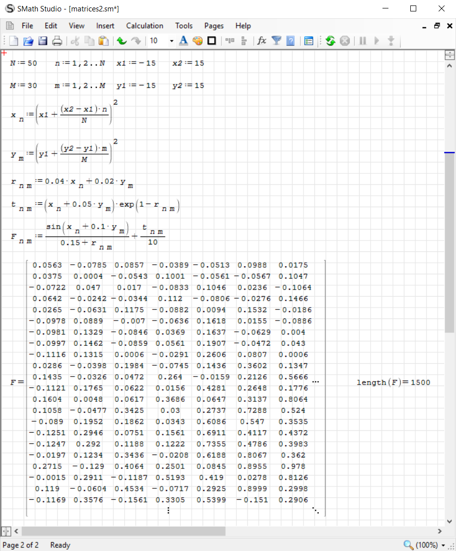

#7 Posted: 2018/1/16 10:56:46
Started implementation of this feature in order to improve compatibility with other software:
Nice feature, Andrey ... keep up !
Vectorize operator works well.
Pattern Mandelbrot RGB.sm (57.12 KiB) downloaded 1251 time(s).
Pattern Mandelbrot.sm (108.74 KiB) downloaded 1193 time(s).
