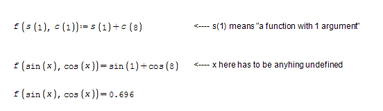

in my recent calculations I needed to have a function that takes two funtions as parameters
and calculates some values. Something like:
k_f(s;c)=s(1)*c(8)
k_f(sin; cos)=
Trying this in SMath Studio unfortunately failed.
Is is possible to implement such a thing in SMath Studio?
Yours,
Pawel Wierzba

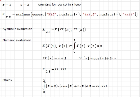

#2 Posted: 7/7/2021 8:32:56 AM
Yes it is possible, see the attached image
#3 Posted: 7/7/2021 9:31:23 AM
Paweł Wierzba
Paweł Wierzba
0 likes in 6 posts.
Thank you very much. Indeed, it works, even with functions with more arguments than one.
Sorry for asking a question about something that has already been implemented.

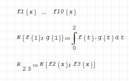

#5 Posted: 7/7/2021 10:11:06 AM
Paweł Wierzba
Paweł Wierzba
0 likes in 6 posts.
Thank you for the advice. Fortunately, standard way of defining functions is well known to me.
Unfortunately, I had to pass functions as arguments, rather than define them the "standard way".
I had several functions and some coefficients to be calculated, based on them.
Something like the example below.
If done the standard way, it would involve a LOT of writing.

#10 Posted: 7/7/2021 3:22:21 PM
1,139 likes in 1,805 posts.
Hi. You can try a for loop with something like this in the body

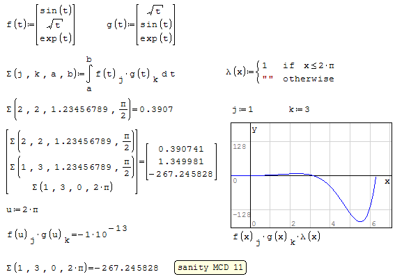

At this point, you are missing a link ... what link ?
Before integration, you must plot the integrand.
That will avoid the Simpson integrator to result scrap.
Visit/search 'Samples' for more integrators [Adaptive, Romberg].

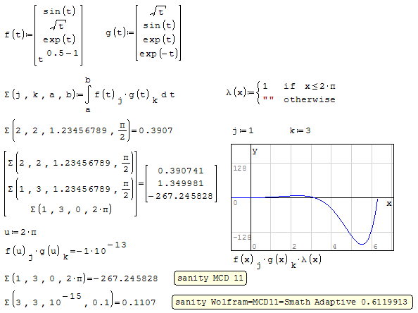

#12 Posted: 7/7/2021 6:02:38 PM

#16 Posted: 7/8/2021 9:45:19 AM
Thank you for help, especially the comment about potential problems
with the integrator and illustrative examples.
I posted the wrong image ... that's the right one.
Don't drop dead by how far simple integration can fly in the blue !

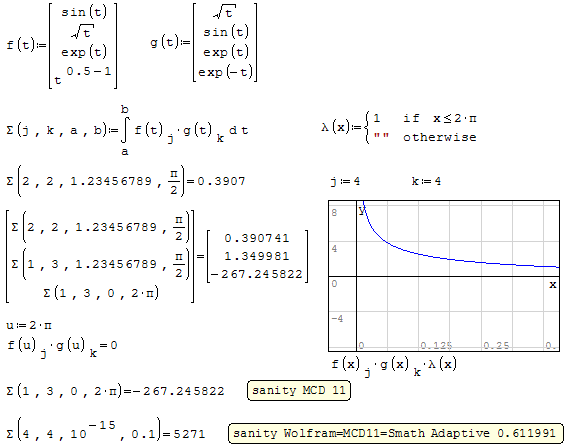

#17 Posted: 7/8/2021 2:44:44 PM
Thank you for help, especially the comment about potential problems with the integrator and illustrative examples.
The 'thanks' button' never worked.
1. The previous image as *,sm
2. My Integration tool box.
Please, don't hesitate for + ... Jean
Integral 000000000000 vectorsf(j,k,a,b).sm (13.15 KiB) downloaded 1754 time(s).
Integral 00000000 MASTER ToolBox.sm (477.13 KiB) downloaded 1776 time(s).
