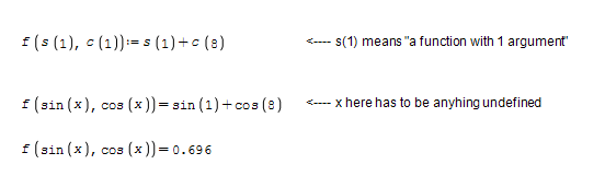

in my recent calculations I needed to have a function that takes two funtions as parameters
and calculates some values. Something like:
k_f(s;c)=s(1)*c(8)
k_f(sin; cos)=
Trying this in SMath Studio unfortunately failed.
Is is possible to implement such a thing in SMath Studio?
Yours,
Pawel Wierzba

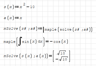

#2 Опубликовано: 07.07.2021 08:32:56
Yes it is possible, see the attached image
#3 Опубликовано: 07.07.2021 09:31:23
Paweł Wierzba
Paweł Wierzba
Thank you very much. Indeed, it works, even with functions with more arguments than one.
Sorry for asking a question about something that has already been implemented.

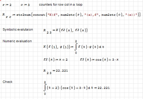

#4 Опубликовано: 07.07.2021 09:36:02
Make it infinite algo style.

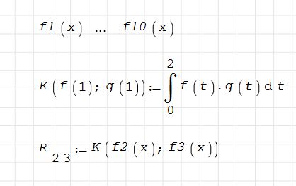

#5 Опубликовано: 07.07.2021 10:11:06
Paweł Wierzba
Paweł Wierzba
Thank you for the advice. Fortunately, standard way of defining functions is well known to me.
Unfortunately, I had to pass functions as arguments, rather than define them the "standard way".
I had several functions and some coefficients to be calculated, based on them.
Something like the example below.
If done the standard way, it would involve a LOT of writing.
#6 Опубликовано: 07.07.2021 10:49:47
Attach the document for understanding that mystic doing.

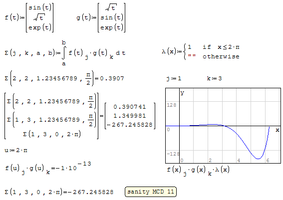

#10 Опубликовано: 07.07.2021 15:22:21
1 132 сообщений из 1 801 понравились пользователям.
Hi. You can try a for loop with something like this in the body
#11 Опубликовано: 07.07.2021 15:31:59
Make it algo style as exemplified.
At this point, you are missing a link ... what link ?
Before integration, you must plot the integrand.
That will avoid the Simpson integrator to result scrap.
Visit/search 'Samples' for more integrators [Adaptive, Romberg].

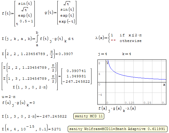

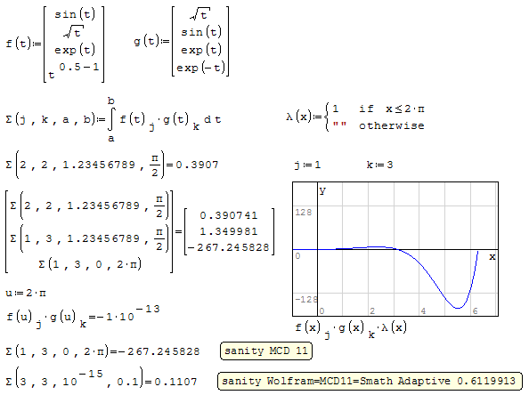

#16 Опубликовано: 08.07.2021 09:45:19
Thank you for help, especially the comment about potential problems
with the integrator and illustrative examples.
I posted the wrong image ... that's the right one.
Don't drop dead by how far simple integration can fly in the blue !
#17 Опубликовано: 08.07.2021 14:44:44
Thank you for help, especially the comment about potential problems with the integrator and illustrative examples.
The 'thanks' button' never worked.
1. The previous image as *,sm
2. My Integration tool box.
Please, don't hesitate for + ... Jean
Integral 000000000000 vectorsf(j,k,a,b).sm (13,15 КиБ) скачан 1670 раз(а).
Integral 00000000 MASTER ToolBox.sm (477,13 КиБ) скачан 1689 раз(а).

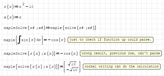

#18 Опубликовано: 08.07.2021 16:25:50
Looks like line() mysteriously solve the issue.
I have come across similar to this behavior before.
#19 Опубликовано: 08.07.2021 17:21:01
Hi. For help understanding what's happen: that behavior is similar to the SetDelayed in Wolfram Mathematica language: https://www.wolfram.com/language/elementary-introduction/2nd-ed/39-immediate-and-delayed-values.html
