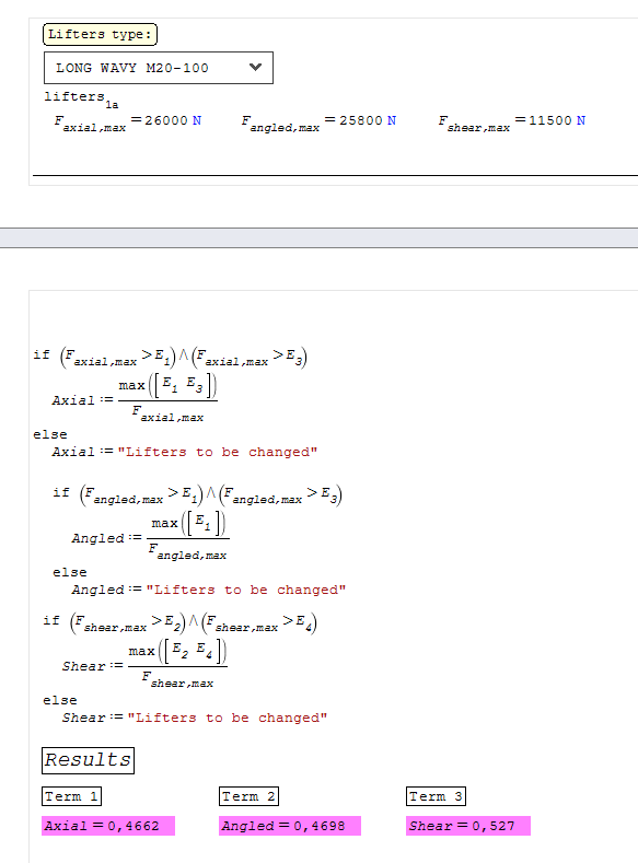

I am new in sMath topic. Can anybody tell me why here my combobox doesn't work correctly? It doesn't download values from rows.
Thanks!

#9 Posted: 8/21/2018 6:57:40 AM
WroteI have identified two errors:
1) you must assign a variable to the combobox
2) seems to have disabled the evaluation of the combobox
Sergio,
can you send me a correct file if it's not a problem?
I now what you mean but that will be the easiest way for me. I still have something incorrect.
Thanks for help
