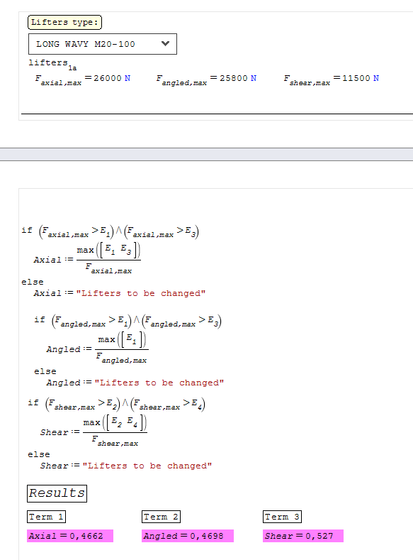

I am new in sMath topic. Can anybody tell me why here my combobox doesn't work correctly? It doesn't download values from rows.
Thanks!

#2 Опубликовано: 20.08.2018 07:12:49
I have identified two errors:
1) you must assign a variable to the combobox
2) seems to have disabled the evaluation of the combobox

#3 Опубликовано: 20.08.2018 11:40:29

this
Lifterscheck.sm (21,4 КиБ) скачан 1273 раз(а).
