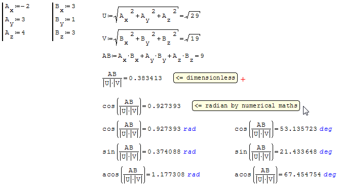

I am new user of Smath and in order to teach myself a bit about this software I am trying make a simple calculation in degrees. However, I cannot find degrees? I cannot find Angle in the insert meny at all? What am I doing wrong?
Best Regards, Magne

This is exactly what I am unable to do! How do I make the trigonometric function return degrees?
Do I simply type the unit after the result? ( I am sorry if these questions are really daft!?)
Magne
#8 Posted: 11/13/2017 6:50:48 AM
All numerical functions are approximations in computing machinery.
Trigonometric function are in radian. If you want result in °
1. click on the empty place holder of the result,
2. click on the unit drop down menu from the tool bar,
3. click on ° or deg ... scroll down for 'rad' if you want result in radian.

Thank you very much! Now I can make it work. I thought I had tried this but I probably used the input "position" wrong, I believe I simply typed it at the wrong place.
Thank you again, this is great forum!
