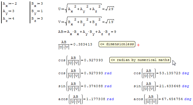

This is exactly what I am unable to do! How do I make the trigonometric function return degrees?
Do I simply type the unit after the result? ( I am sorry if these questions are really daft!?)
Magne
#8 Опубликовано: 13.11.2017 06:50:48
All numerical functions are approximations in computing machinery.
Trigonometric function are in radian. If you want result in °
1. click on the empty place holder of the result,
2. click on the unit drop down menu from the tool bar,
3. click on ° or deg ... scroll down for 'rad' if you want result in radian.
