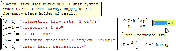

#2 Posted: 10/24/2017 10:59:27 AM
... many more Engineering don't come as easily as 2*3=6 m²
You don't have to freak Smath unit system, just like this:
... rather like this
