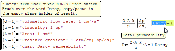

... many more Engineering don't come as easily as 2*3=6 m²
You don't have to freak Smath unit system, just like this:
... rather like this
