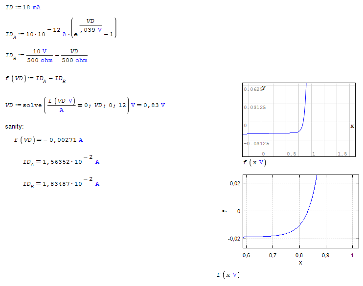

I am a new SMath user - I am using the software as a replacement for Mathcad while I am doing some self study on electronic devices and circuit theory.
I am a bit stuck right off the get go - I have been able to do basics but now need to solve for two equations and two unknowns. I realize in Mathcad this is
essentially a "Give...Find" scenario. I suspect in SMath Studio I need to use (solve), but that is not working me.
Here is what I have so far:
Any assistance appreciated.

#4 Posted: 3/9/2020 10:35:37 PM
WroteI am a new SMath user - I am using the software as a replacement for Mathcad
... reading you further and your objective study, you will
need solid solve companion. In Mathcad, you can iterate
given/Find and root. Similar/same can be done in Smath.
This Treasury is a kind of initiating tool box.
Just a matter to get used to Smath coding, very visual.
Enjoy and don't hesitate.
Solve TREASURY_1 [Iterate L, Lc].sm (235.4 KiB) downloaded 1094 time(s).
