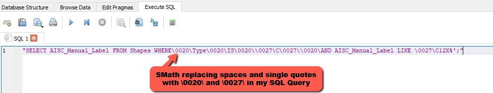

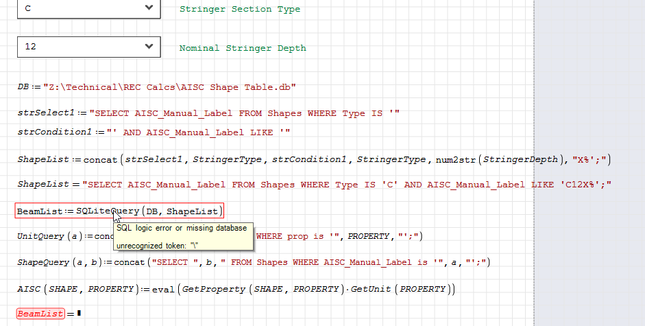

I don't know if this is the right place to post this, but I think the issue I'm seeing is with the SQLite plugin. I compose a query based on some user input via combo boxes, concatenate all the parts together into a string, and then use the SQLiteQuery function to query the AISC Table database. This normally works well. Now, I get an error indicating that a "\" symbol is interfering. The database file location has that symbol, but I don't think that is the issue. When I look at the resulting string in SMath, it looks like correct syntax. But when I copy it into DB Browser, it shows all of the spaces and single quote marks in the query string translated as \0020\ and \0027\ respectively. If I manually replace those in DB Browser, the query runs as anticipated. Is there any way to get that corrected? I'm using SMath version 0.99.7786.

Plugin updated. Please try.
Changes:
- plug-in corrected to respect latest SMath Studio API changes.
sergio 5/18/2021 2:08:00 PM, Jason McCool 5/18/2021 3:50:00 PM

Thank you! That worked great. You rock!
