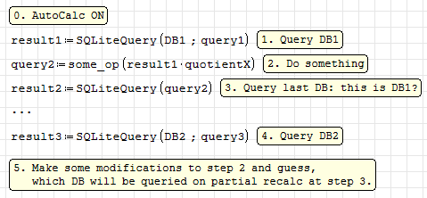

  • 31/08/16 - Removed single argument SQLiteQuery due to inconsistencies with partial recalculation. Null entries in database return custom unit 'NULL and are now distinguishable from empty strings, simplified code. Fixed and improved the example file, added typetest table to example database

  1. Could you consider using a identifier (number or string) as a "handle" to open connection? For example,
    SQLiteOpen("connection1","path1"="open"
    SQLiteOpen("connection2","path2"="open"
    m:=SQLiteQuery("connection1","query"
    query2:=<some processing involving m>
    SQLiteQuery("connection2",query2)
    <some other processing with both connections 1 and 2>
    Or the SQLiteOpen could return the numeric handle on succcess, or an error with a description on failure.

Partial recalculation seems to work as far as I can tell.
You are quite right, closing the database connection in the end makes a full recalculation necessary.
Closing the database file is not necessary if the database is only read. At the latest when SMath Studio is closed the database connections are terminated. I am however not sure whether "SQLiteClose" can be safely ignored if write operations to the database have been performed.
Opening a file will not impose additional overhead if the file is already open. The plugin will now recognise this and simply report the handle.

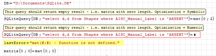

Next question/feature request: a UI for creating DB and tables. That would be wonderful, esp. for those who don't have other utilities for that. I don't think it's best done with custom functions, rather some dialog UI would be perfect... or a menu item that starts a free external utility for that, that is distributed in the directory with the plugin. Well, I propose dialog UI just because I don't see a good way to do it via functions - but I may well be wrong...
Also:
SQLiteQuery(0,"select * from Shapes"
gives me an error "The cast is illegal" (translated from Russian - specific wording may differ).
SQLiteQuery(0,"select * from Units"
works OK
I suppose it may have something to do with decimal separator? Or a problem when returning an empty value?

Testing 1.0.6083.4
Previously reported errors are gone, thanks!
But I see a problem with returning empty result sets:
Something's wrong with the approach I suggested (using matrix(0,n)). Maybe Andrey could suggest something here?
С уважением, Михаил Каганский

#13 Posted: 8/29/2016 2:32:52 PM
I think the approach "matrix as result" is good, maybe there is something to improve in the SS logic. If you try to assign matrix(0,n) to a variable, you can show mat(0,n) in a standalone display of the result with numeric evaluation if at definition is stored symbolically, but not if it is stored numerically (that is the same error while you are trying to display the inline result); this affects also rows()/cols()/length() (unable to process the variable when it is stored numerically). I'll talk with Andrey about this.
BTW 'NULL as result is very good idea, +1 for this.

I must yet get used to your new status as SMath co-developer. I haven't yet had a chance to congratulate you with that Thank you for all your past and future contributions! And I will remember to address my questions WRT SMath internals to both of you from now on.
WRT empty matrices. There used to be yet another application for them: using as initializers for loops, to assign an empty n-col 0-row matrix to a variable, and then use stack() uniformly in a loop to fill it (of course, if the number of rows is known in advance, that may be done differeently and more efficient). This functionality was definitely available at some point (unfortunately, I cannot find a link to it atm, because I explained this technique in Russian forum, that is unavailable now).

Thanks for the congratulations Mike. I'm very grateful to Andrey for this opportunity
I know about this useful feature, that's why I think this particular form should be enforced

I have updated the plugin
with the following changes (link in initial post):
  • Removed single argument SQLiteQuery due to inconsistencies with partial recalculation.
  • Null entries in database return custom unit 'NULL and are now distinguishable from empty strings, simplified code.
  • Fixed and improved the example file
  • Added typetest table to example database and tested every case successfully
Thanks yet again for all the useful feedback I've received.
I completely oversaw this issue, to preserve consistency and repeatability even with partial recalculation I have removed the single argument version of SQLiteQuery
