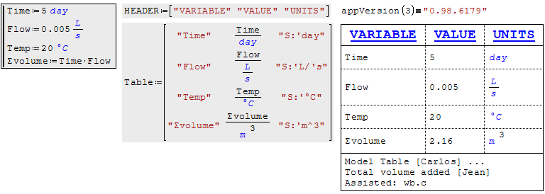

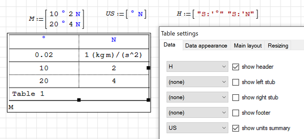

You can only specify units for the whole result, useless in your scenario.
You have to extract submatrices and display those separately.
The table region provides some extended options. There you can specify column or row units but you have to write them explicitly to the header if you want a nice display of column units.
This is sort of redundant and therefore error-prone input.

#3 Posted: 5/25/2020 7:37:02 AM
how to change the units of a matrix with text in some slots of the matrix.
Inst_Colebrook Pipe Data.sm (60.97 KiB) downloaded 1529 time(s).
frapuano 5/25/2020 10:32:00 AM
