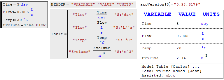

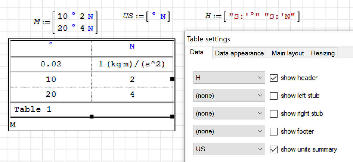

You can only specify units for the whole result, useless in your scenario.
You have to extract submatrices and display those separately.
The table region provides some extended options. There you can specify column or row units but you have to write them explicitly to the header if you want a nice display of column units.
This is sort of redundant and therefore error-prone input.

#3 Опубликовано: 25.05.2020 07:37:02
how to change the units of a matrix with text in some slots of the matrix.
Inst_Colebrook Pipe Data.sm (60,97 КиБ) скачан 1529 раз(а).

Is there any way to fix the improper positioning of text (which start with "S:') when used in tables?
Misalignment is so obvious, blue colored special text is always a bit upper in tables than the rest as it can be seen at this example too.
#5 Опубликовано: 25.05.2020 18:05:22
Is there any way to fix the improper positioning of text (which start with "S:' when used in tables?
What's wrong with such perfect Table ?
#6 Опубликовано: 26.05.2020 10:43:54
What Jean says is: Stick with build 6179. The problem is version-dependent. The new text engine has multiple alignment problems, not only vertical but also horizontal (long words in text tend to overlap). It is just an intermediate step towards extended functionality. Using the newest version and reporting problems can be understood as a way to support the project and pay for use of free software.

Thanks to everyone that has posted, I was unaware of the Table feature. I think the table feature should definitely help with the type of formatting and layout of the results I was hoping to achieve.
Regards.
