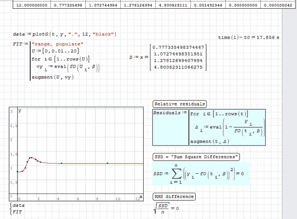

For this particular example, Carlos algorithm spits out in < hart beat !
Thanks again Carlos, it will surely help revamp some/many of the GenfitMinimize.
Levenberg_Marquardt_Code_CBG Copy.sm (65.28 KiB) downloaded 1163 time(s).

Thanks, Carlos: works fine.
More doctoring for you !
The work sheet "Otherwise" is only slightly otherwise for convenience, works fine.
The "Jacobian Fails" is another model attempted, Jacobian complains ... Ah !
Same model Pharmacokinetics works fine Conjugate gradient Minimize.
True: some model function can only be fitted by hand
True: GenfitMinimze may be difficult to initialize but work fine for my huge
collection [about 80 projects in Smath].
Levenberg_Marquardt_Code_CBG Model Otherwise Jacobian FAILS.sm (35.77 KiB) downloaded 1163 time(s).
Genfit Pharmacokinetics.sm (43.67 KiB) downloaded 1108 time(s).
Levenberg_Marquardt_Code_CBG Model Otherwise.sm (53.53 KiB) downloaded 1171 time(s).

Thanks Carlos for doctoring.
By some regrouping, timing dropped from 3.8 min down to 2.6 min.
Niece Smath document for classroom and publishing.
Genfit Pharmacokinetics L-M Copy.sm (60.57 KiB) downloaded 1055 time(s).

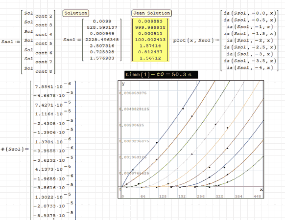

Hi Jean
Another example of the application of the Levenberg Marquardt algorithm,
this time with the Tesla function.
Levenberg_Marquard_Tesla_OK_CBG.sm (546.62 KiB) downloaded 1173 time(s).
