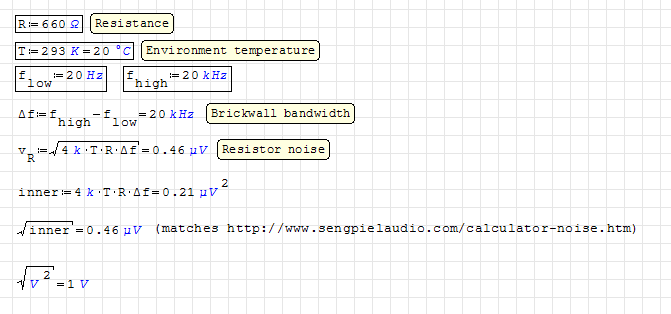

#1 Posted: 7/14/2014 11:34:46 AM
I had a worksheet that worked in the past, but now it doesn't, saying "operation cannot be performed with units", because it's sqrt(V^2)? But if I break it up into two steps it works:

#4 Posted: 7/14/2014 12:57:40 PM
Actually, no, the original worksheet is not working, only the copy that I uploaded

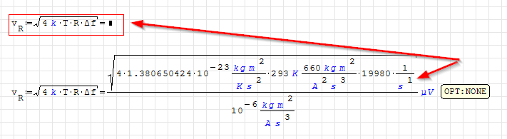

#5 Posted: 7/14/2014 1:23:39 PM
I've already seen this bug, sometimes comes to light...
when the SMath engine output unitary exponents on units, square root fails.
Refreshing the worksheet alternately works/doesn't works.
[EDIT] Added in the BTS: SS-177
