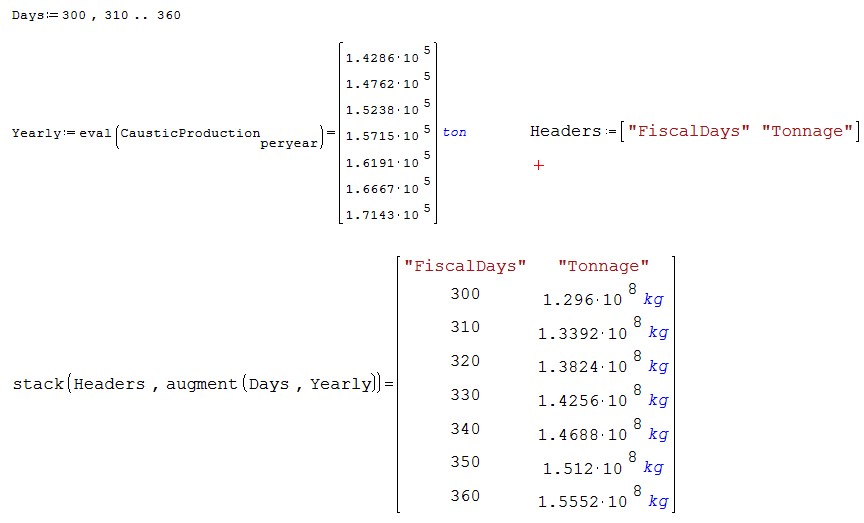

The question is simply clear ...its should be a matter of removing or adding x3 zeros
aMIR.sm (10.5 KiB) downloaded 1127 time(s).

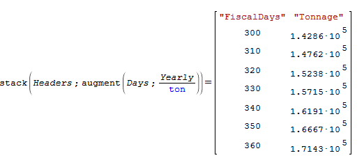

#2 Posted: 5/14/2018 5:36:20 AM
Simple as the question

Thanks ...but can you tell me what is the wrong in this kg <> ton ...it should just reduce the power to 10 from 8 to 3 without changing the values

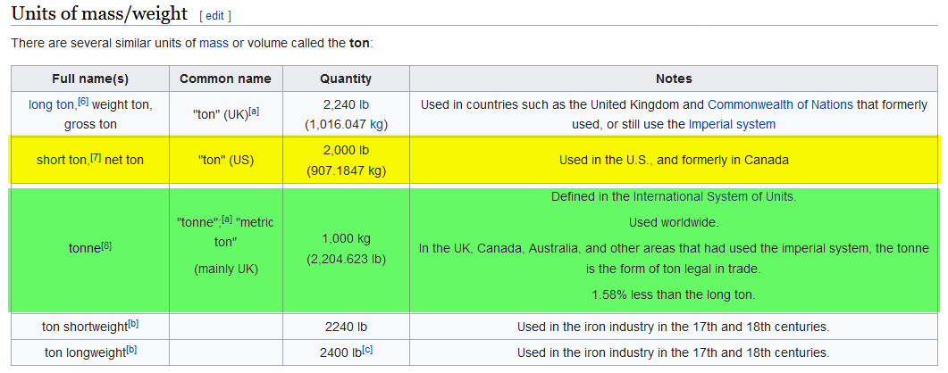

You have to use 't (metric ton) because 'ton here is the US "short ton"

I think its the problem ...I was expecting MetricTons
Problem solved
