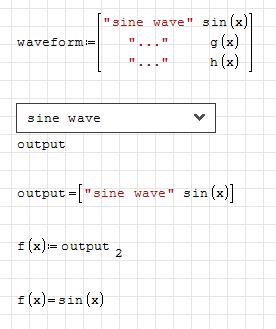

#3 Posted: 2/23/2017 3:21:35 PM
1,440 likes in 2,929 posts.
You might use combobox or comboboxlist regions
