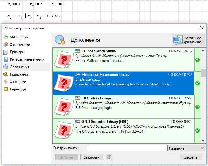

Hello,i have r1=3 r2=7 r3=9
is the some operator that will do the parallel operator?
1/rt =1/r1 +1/r2 +1/r3
Thanks
#2 Posted: 5/29/2019 7:45:11 AM
1,555 likes in 1,867 posts.
EEL_Rpar() function from the Electrical Engineering Library:
r.Σ:EEL_Rpar(r.1,r.2,r.3)

Sorry, I don't understand parallel operator.
This operator let's you calculate the total resistance of resistances in parallel
More explicitly...
