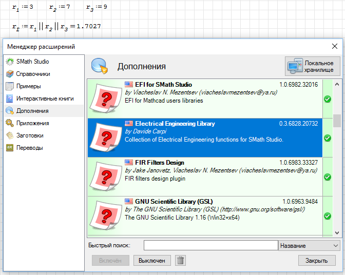

Hello,i have r1=3 r2=7 r3=9
is the some operator that will do the parallel operator?
1/rt =1/r1 +1/r2 +1/r3
Thanks
#2 Опубликовано: 29.05.2019 07:45:11
1 554 сообщений из 1 864 понравились пользователям.
EEL_Rpar() function from the Electrical Engineering Library:
r.Σ:EEL_Rpar(r.1,r.2,r.3)

#5 Опубликовано: 30.05.2019 11:20:02
Oscar Campo
Oscar Campo
Sorry, I don't understand parallel operator.
This operator let's you calculate the total resistance of resistances in parallel
Arie 31.05.2019 12:00:00
#6 Опубликовано: 31.05.2019 11:59:35
Arie
Arie
More explicitly...
