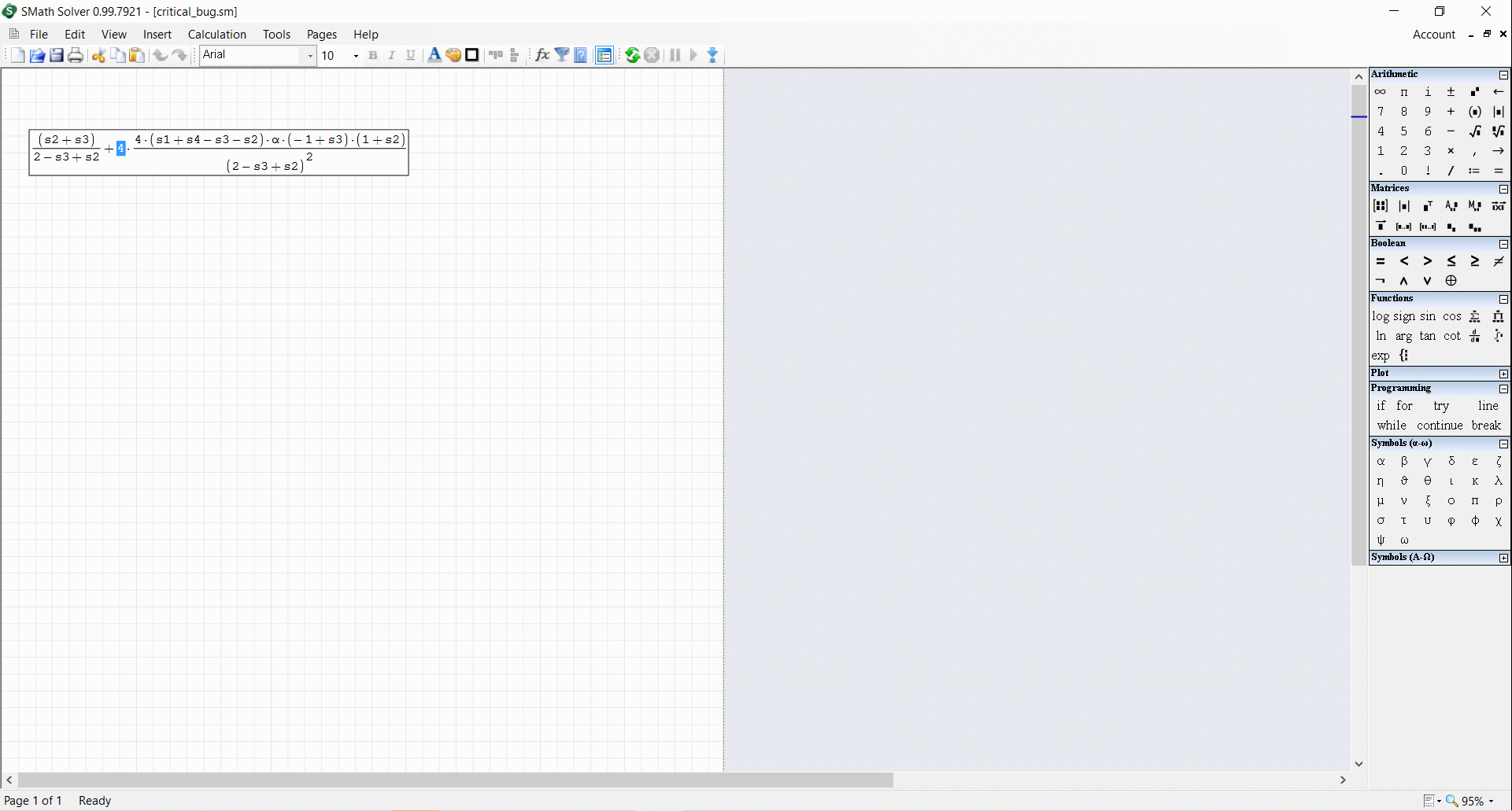

Eventually I have caught a bug that bothered me in a few latest versions of Smath.
critical_bug.sm (3.85 KiB) downloaded 1672 time(s).
Try to delete the first number "4" in front of the ratio.
Step 1: Select it with the cursor.
Show Spoiler
Step 2: Press "Del", the "4" turns into a black square.
Show Spoiler

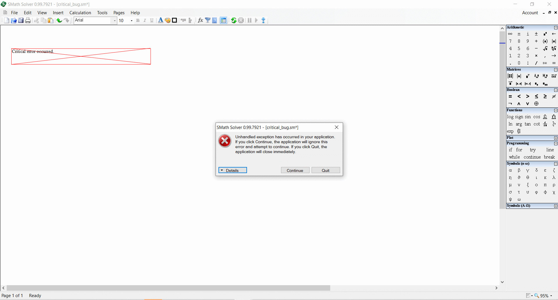

Step 3: Press "Del" once again. SM pops on "Critical error".
Show Spoiler

Jean,
It can't be doctored, it is not a calculation issue.
Smath Studio crashes at the moment you push "DEL" key to delete this number "4" or whatever else there.

Thank you, confirmed
System.IndexOutOfRangeException: Index out of matrix bounds.
   in SMath.Controls.MathPainter.PrepareForPaint(MathRegion region, PaintContext ctx, Term[] input, MathAnswer answer, Term[] units, Boolean inputDataVisibility, Int32 currentTermIdx, FontInfo font, Boolean focused, Single& middleLine, Single& baseLine)
   in SMath.Controls.MathRegion.(IGraphics , PaintEventOptions )
   in SMath.Controls.MathRegion.OnCommandSend(String value)
   in SMath.Controls.WorksheetEditor.(RegionBase , String )
   in SMath.Controls.WorksheetEditor.InsertManager(String value)
   in SMath.Controls.Worksheet.Insert(String value)
   in SMath.Controls.WorksheetEditor.KeyDown(KeyEventOptions e)
   in SMath.UI.Accessories.DesktopWorksheet.OnKeyDown(KeyEventArgs e)
   in System.Windows.Forms.Control.ProcessKeyEventArgs(Message& m)
   in System.Windows.Forms.Control.WmKeyChar(Message& m)
   in System.Windows.Forms.Control.WndProc(Message& m)
   in System.Windows.Forms.NativeWindow.Callback(IntPtr hWnd, Int32 msg, IntPtr wparam, IntPtr lparam)

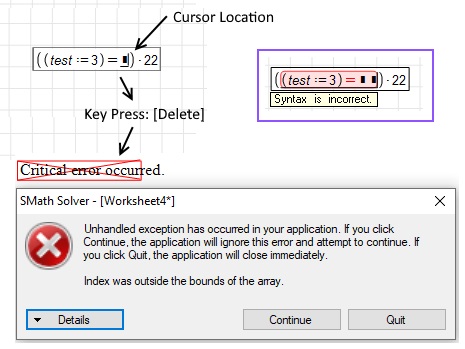

I can also confirm the existence of this issue ( "v0.99.7921.69" ). Upon investigation, I have (2) items:
  1) The program does not actually 'crash', the program is still running. Thus: you can recover from this bug without losing all your work!
      a) To recover from this error:
            1) On the "⨂ Unhandled exception has occurred ... Index was outside the bounds of the array" popup error message, Click on the button: 「Continue」
            2) 'UNDO' your last action, either via the menu bar: 「Edit」 -> 「↻ Undo」 or via keypress 「Ctrl」 + 「Z」
            3) Repeat steps #1 and #2 until you achieve a successful 'undo'.
  2) The elements of this error seem to require a grouping operator (e.g., Absolute Value, Parenthesis, Determinant, Square Root, Matrix) that is paired with a fraction/division operation, prepend this with a multiplication statement and you can duplicate the error. See screen capture below:
Below are a few statements I compiled; performing the double-delete on the integer '6' will throw the same error:
-Kenny Lemens, P.E.

I found another configuration that can trigger this error; if you declare/evaluate a variable, and then try to multiply that entire set: you get a syntax error. Now if you attempt to correct the statement by using the [DEL] to remove the evaluation, the error gets thrown (as shown below):
The work around would be to use the [Backspace] to delete/correct the equation, or to copy/paste the terms into a new statement without syntax errors.
-Kenny Lemens, P.E.
