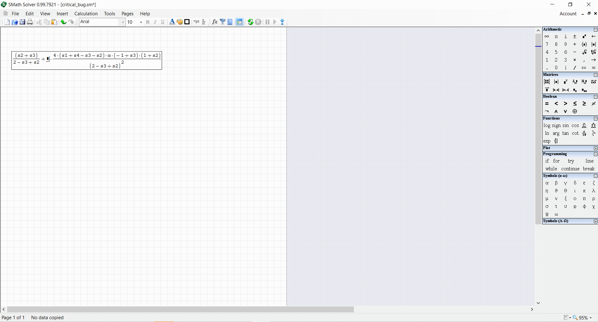

Eventually I have caught a bug that bothered me in a few latest versions of Smath.
critical_bug.sm (3,85 КиБ) скачан 1632 раз(а).
Try to delete the first number "4" in front of the ratio.
Step 1: Select it with the cursor.

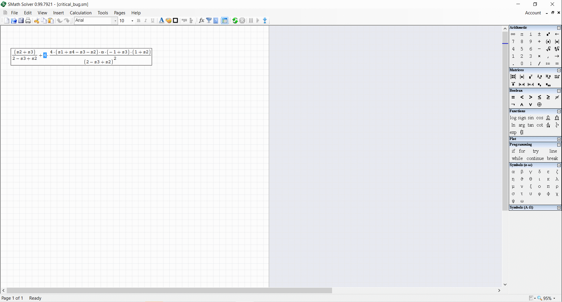

Step 2: Press "Del", the "4" turns into a black square.
Показать спойлер

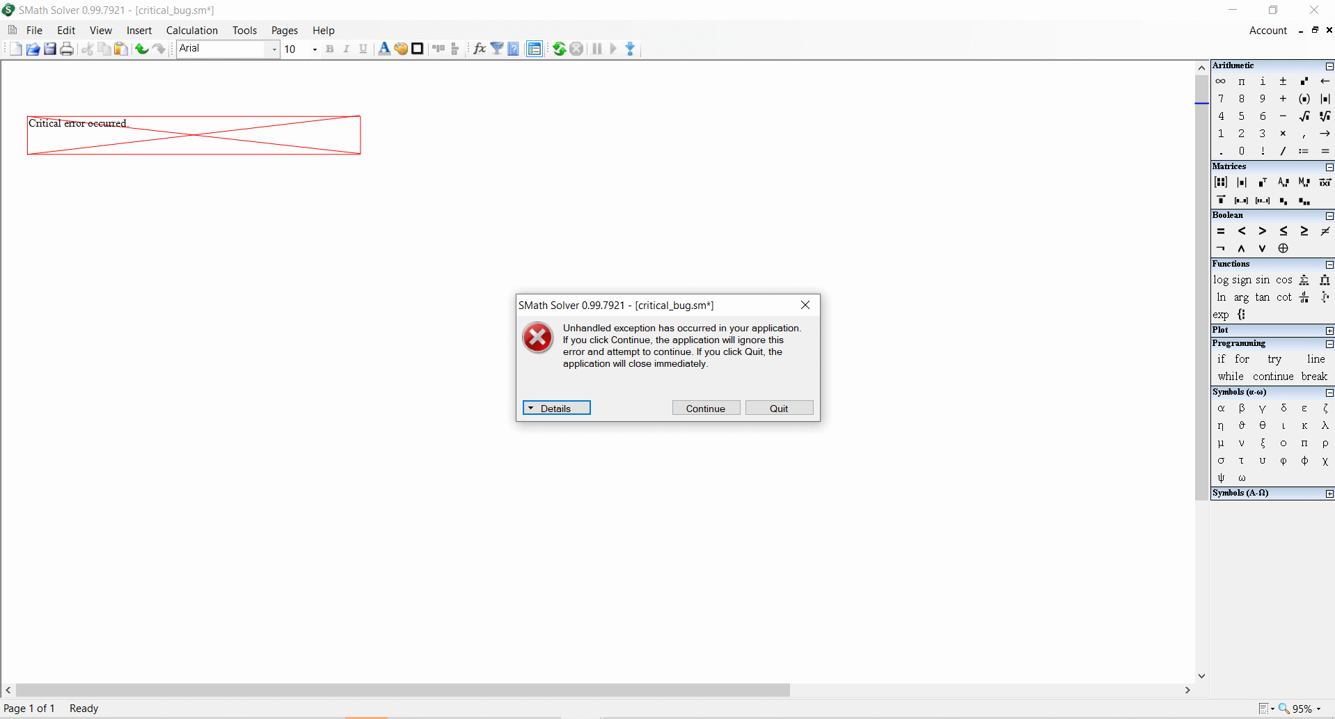

Step 3: Press "Del" once again. SM pops on "Critical error".
Показать спойлер

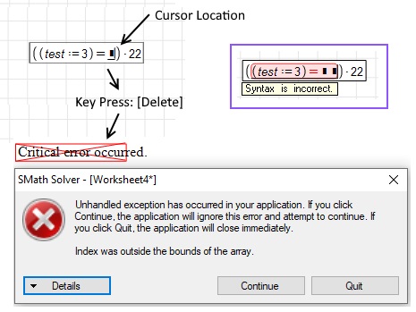

Greetings,
I found another configuration that can trigger this error; if you declare/evaluate a variable, and then try to multiply that entire set: you get a syntax error. Now if you attempt to correct the statement by using the [DEL] to remove the evaluation, the error gets thrown (as shown below):
The work around would be to use the [Backspace] to delete/correct the equation, or to copy/paste the terms into a new statement without syntax errors.
-Kenny Lemens, P.E.
