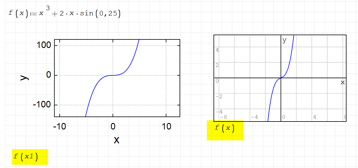

#3 Posted: 10/25/2021 2:35:07 PM
127 likes in 342 posts.
You have defined a vector of values ​​for x. If you use the X-YPLOT plugin you need to change the variable. If instead you use SM native 2D graph then it already works as you expect

#6 Posted: 10/25/2021 3:13:44 PM
Renzo Choque
Renzo Choque
6 likes in 18 posts.
Hi, if you need a quick plot I recommend you use 2D standard plot you can plot functions f(x) directly , if you need a more configurable plot use XY plot but you need to put your data in a special format. File not found.File not found.

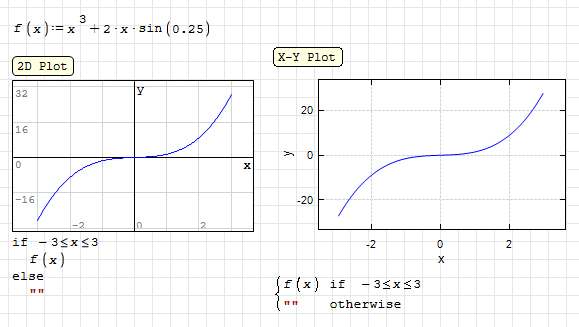

#7 Posted: 10/25/2021 3:29:09 PM
600 likes in 1,381 posts.
You don't need to use range() and augment() if you want to plot sections.
You can limit it with if-else() or cases().

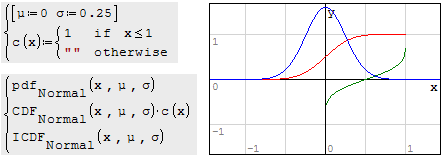

#9 Posted: 10/25/2021 3:50:14 PM
... besides the pure statistical application,
you can use to fit data sets [Fréchet US Rainfall ...]
#10 Posted: 10/25/2021 3:52:41 PM
There is about 24 built-in PDF in Smath ... f(x) menu
as well as CDF, ICDF
#11 Posted: 10/26/2021 7:05:13 AM
Equation 1 - Normal distribution does not solve as a function until it is vectorized. Why?
1. Discretize the range you want and plot ... No vectorize.
2. Plot scalar directly.

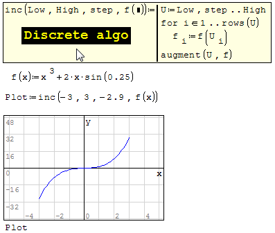

#13 Posted: 10/26/2021 8:20:56 AM
... in most applications inc(Low,High,step,f(#)) is preferred
Paecific.sm (14.25 KiB) downloaded 1278 time(s).
#14 Posted: 10/26/2021 9:50:27 AM
Scalar plots have limited use, mostly confirm the project.
Discrete plot can be used for subsequent application/export.
1. Collapsed the algo at top utilities.
2. Use it infinitely in-situ use [range each f(x) at will].
#15 Posted: 10/26/2021 11:29:10 AM
Try this file.
Smath - 2D Plots_r1.sm (17.22 KiB) downloaded 1291 time(s).
