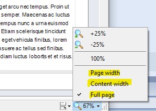

  • The following auto scaling modes added: page width, content width, full page;

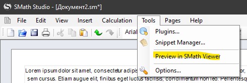

  • Preview in SMath Viewer menu item added to Tools menu;

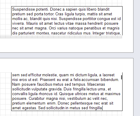

  • Added support for Regions with custom line breaks;
  • Support for page breaks added for Container Regions;
  • "Break on pages bounds" menu item added to Text Region (option turned on by default for new documents).

  • New scaling modes:
  • Preview in SMath Viewer:
  • Line breaks:
What's "SMath Viewer"?
#6 Posted: 12/4/2020 7:33:42 PM
2,345 likes in 4,059 posts.
Hi. Sorry if it's a silly question, but, from the post I read:
> Changes introduced in current build
> Improvements
Hello.
Please look into the following thread for the details about SMath Viewer: https://en.smath.com/forum/yaf_postst1784_SMath-Viewer.aspx

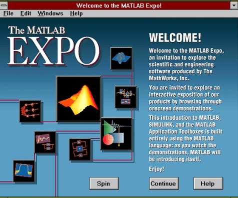

Oh, thanks. I forgot that this is the name for make executables files. I guess that isn't the best name for that! Usually "Viewer" means a version for read files but without buying the software. There are also another "modes". Mathcad have some other. For instance, the web application server, with a lot of examples from Valery Ochkov. This could be a good bussines area for SMath for distribute worksheets in an enterprise intranet.

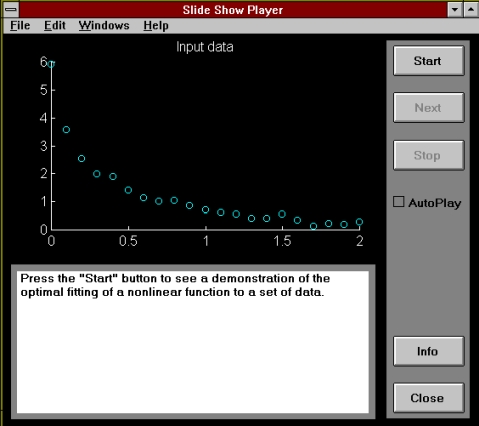

I think that the viewer "mode" is more than an "application server", but without a web based interface. Matlab have those both modes too. For example, this is the "Matlab expo" from an old version.
This is yow it look for one example
Notice that this could be called like a "slide mode" for matlab, but make those slides requires programming skills.

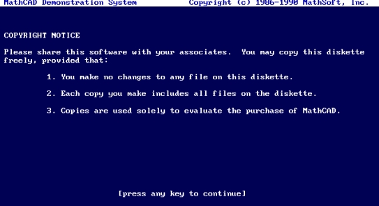

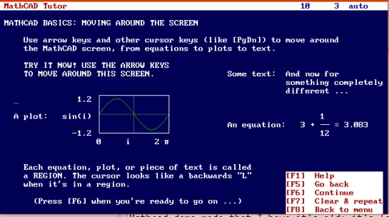

Mathcad demo mode that I have it's old: it's for DOS. Here the starting msg saying that it is free for distribute, under certain conditions:
And here is how it looks:
This is the demo folder for mathcad for DOS.
