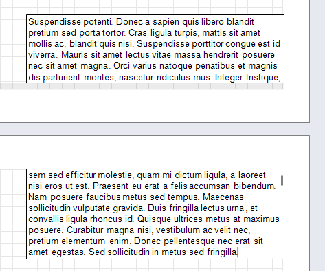

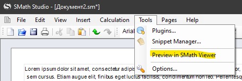

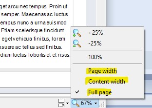

  • New scaling modes:
  • Preview in SMath Viewer:
  • Line breaks:

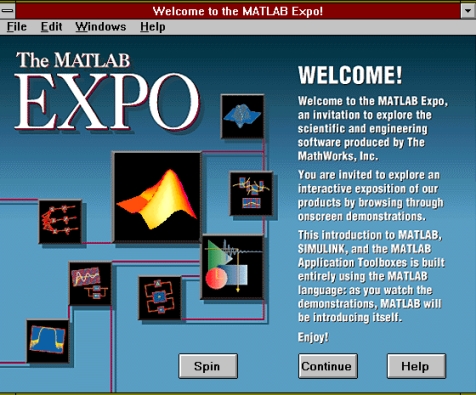

I think that the viewer "mode" is more than an "application server", but without a web based interface. Matlab have those both modes too. For example, this is the "Matlab expo" from an old version.

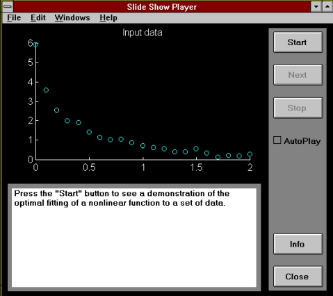

This is yow it look for one example
Notice that this could be called like a "slide mode" for matlab, but make those slides requires programming skills.

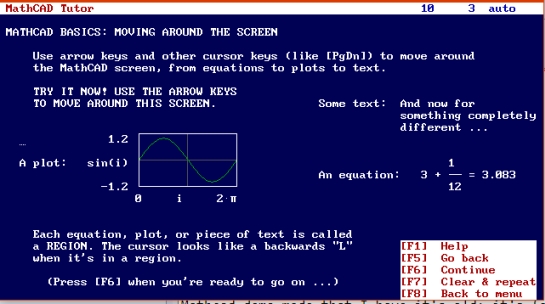

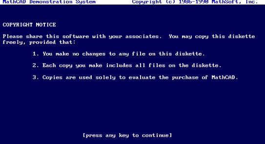

Mathcad demo mode that I have it's old: it's for DOS. Here the starting msg saying that it is free for distribute, under certain conditions:
And here is how it looks:
This is the demo folder for mathcad for DOS.
