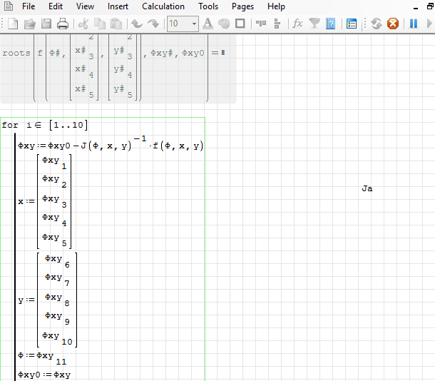

We all know that the symbolic engine in SMath can give us a headache sometimes (or to often?). Here is a situation when we can not interrupt a never-ending calculation.
Primer38b.sm (47.31 KiB) downloaded 1398 time(s).

WroteWe all know that the symbolic engine in SMath can give us a headache sometimes (or to often?). Here is a situation when we can not interrupt a never-ending calculation.
6179 does not crash. It ends @ Syntax is incorrect.
It does not understand "roots" and the otherwise Jacob.
... from an input vector, you apply some maths
ending to a resulting vector. What are you
attempting to solve between these two vectors ?
Primer38b [Unknown].sm (50.24 KiB) downloaded 1165 time(s).
