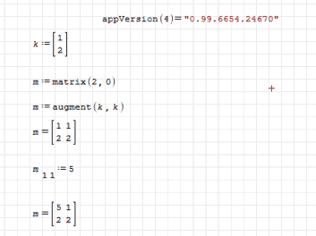

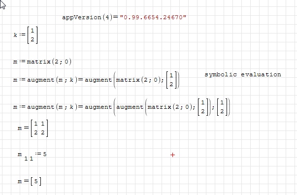

Hi, what am I doing wrong?
m matrix looses it's contents and dimensions after I assigned a single element.
Edit: I found an ugly fix. First I have to create matrix of (2;1) instead (2;0) elements. After all augmenting I have to use submatrix to get rid of first column.
Michal

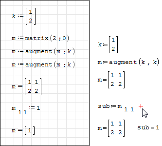

#2 Posted: 3/22/2018 1:04:56 AM
Just like this.
#3 Posted: 3/22/2018 1:49:29 AM
CBG
CBG
78 likes in 312 posts.
Something like this?
Ass_elem_Matrix.sm (4.52 KiB) downloaded 1026 time(s).

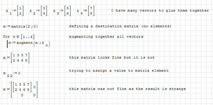

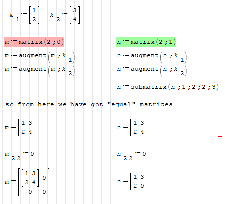

Ok, I probably did not clarify my real needs.
I have some matrices. I just exclude single column from each of them and then I glue them together.
So in my real sheet I never glue the same matrix twice.
Here comes another example where I try to augment some vectors to new matrix.
I have many vectors and they are indexed so I can use program to augment them in a loop.
#5 Posted: 3/22/2018 8:08:01 AM
1,364 likes in 2,281 posts.

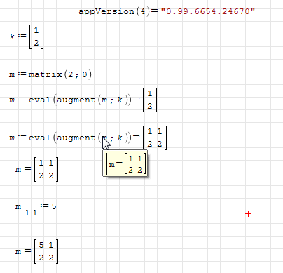

The issue is in the type recognition on the left hand side.
m is a matrix-valued expression rather than a matrix (expression with mat() being the top level object). We had this already with index values being expressions instead of variables.
Thus, the existing m is not recognized as a matrix and therefore not modified but overwritten.
You need to make sure that m is actually stored as matrix, i.e. by applying eval() or by just evaluating numerically (you did symbolically)
I'd prefer SMath to actually check if m evaluates to a matrix and then deciding what to do.
Ass_elem_Matrix_Kr.sm (5.67 KiB) downloaded 979 time(s).
Davide Carpi 3/22/2018 8:16:00 AM, sergio 3/22/2018 9:00:00 AM

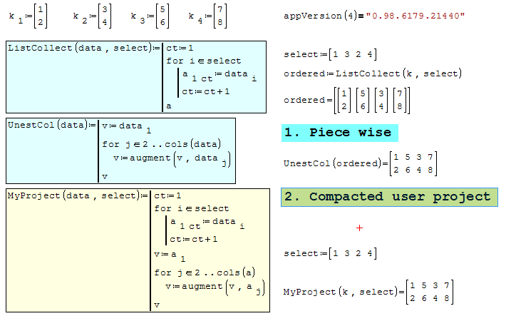

#6 Posted: 3/22/2018 10:21:30 AM
That will handle your projects more conveniently.
Poland.sm (15.33 KiB) downloaded 992 time(s).

Thank you for both your answers. It clarified the situation.

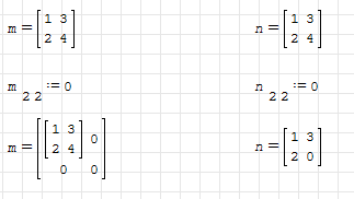

However I think if something looks like matrix it should behave like one. But it is not.
The history of building a matrix affects it
And I treat it as a flaw.
error_matrices_notequal.sm (8.49 KiB) downloaded 991 time(s).

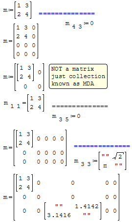

#13 Posted: 3/26/2018 11:23:55 AM
So I have two matrices in front of me (see screenshot)
Your original 'm' is a matrix.
Your concluded 'm' is NOT a matrix, simply a collection.
You can't apply any matrix calculation.
Make it a matrix and continue the project.
