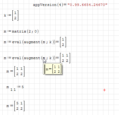

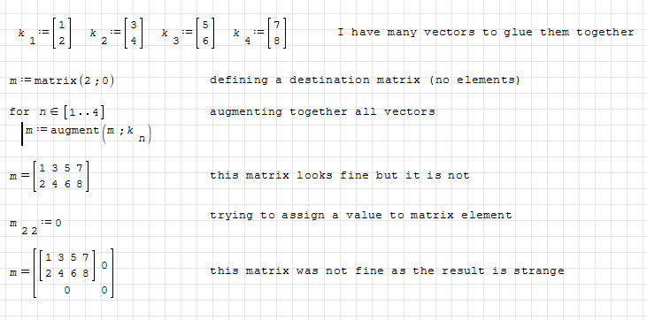

Hi, what am I doing wrong?
m matrix looses it's contents and dimensions after I assigned a single element.
Edit: I found an ugly fix. First I have to create matrix of (2;1) instead (2;0) elements. After all augmenting I have to use submatrix to get rid of first column.

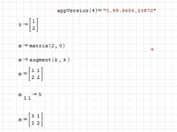

#3 Опубликовано: 22.03.2018 01:49:29
CBG
CBG
Something like this?

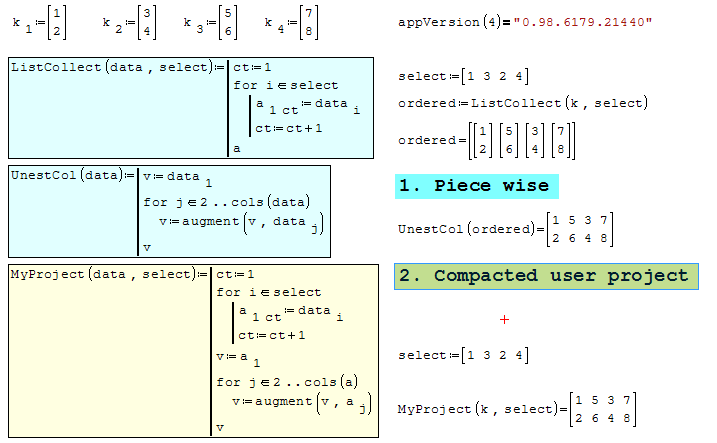

Ok, I probably did not clarify my real needs.
I have some matrices. I just exclude single column from each of them and then I glue them together.
So in my real sheet I never glue the same matrix twice.
Here comes another example where I try to augment some vectors to new matrix.
I have many vectors and they are indexed so I can use program to augment them in a loop.
#5 Опубликовано: 22.03.2018 08:08:01

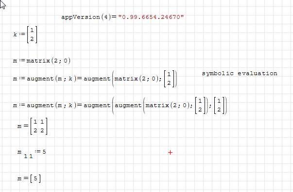

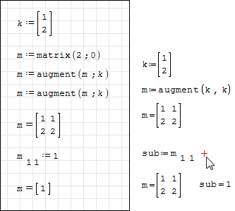

The issue is in the type recognition on the left hand side.
m is a matrix-valued expression rather than a matrix (expression with mat() being the top level object). We had this already with index values being expressions instead of variables.
Thus, the existing m is not recognized as a matrix and therefore not modified but overwritten.
You need to make sure that m is actually stored as matrix, i.e. by applying eval() or by just evaluating numerically (you did symbolically)
I'd prefer SMath to actually check if m evaluates to a matrix and then deciding what to do.
That will handle your projects more conveniently.
Poland.sm (15,33 КиБ) скачан 992 раз(а).

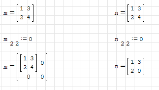

Thank you for both your answers. It clarified the situation.
However I think if something looks like matrix it should behave like one. But it is not.
The history of building a matrix affects it
And I treat it as a flaw.
error_matrices_notequal.sm (8,49 КиБ) скачан 991 раз(а).
#8 Опубликовано: 24.03.2018 19:01:20
The flaw is that m is not evaluated before applying the by-element assignment.
you can, however, enforce this by setting the previous two assignments to numeric optimization in the context menu.
This complies to the survival rule "never use symbolic optimization unless you know what you are doing".

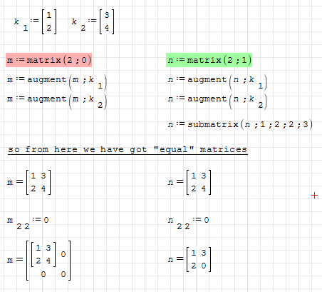

First of all, I want to say, that I like SMath Studio very much and I use it, whenever I have to prepare some calculations for students or in my projects. I once was co-author of book covering exercises in Mathcad. SMath studio is small, uncluttered and (mostly) does what is expected to do. And is free so I don't have to manage licenses, take care of keys and so on. I once paid some bucks to the author and gladly repeat it as program gets better.
But coming back to my being more specific: If I see matrix in the code (not necessarily mine) I expect it to behave like matrix and that's all.

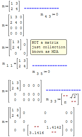

Let's assume I got quite large project which can also reference to other files by include("..." ) add-in. So I have two matrices in front of me (see screenshot). I want to change a single element in each of them. Shall I go back and read all the code before to check if it can be done? The general question is: if we have two identical looking chairs shall we expect one of them not to be a chair but a briefcase with a chair in it?
#13 Опубликовано: 26.03.2018 11:23:55
Your original 'm' is a matrix.
Your concluded 'm' is NOT a matrix, simply a collection.
You can't apply any matrix calculation.
Make it a matrix and continue the project.
#14 Опубликовано: 26.03.2018 12:29:20
