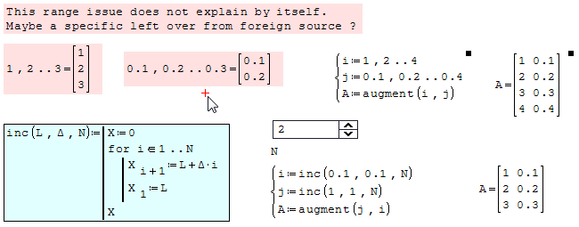

Hi. Is that ok?
range_issue.sm (2.74 KiB) downloaded 1314 time(s).

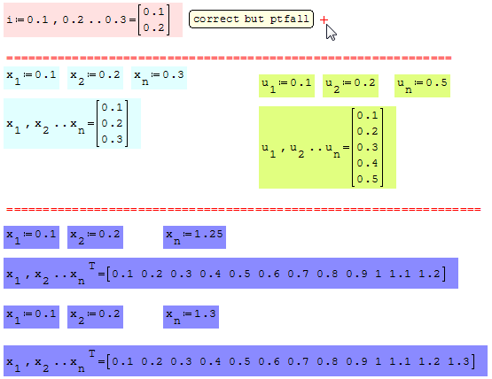

Certainly NOT for use.
range_issue(1).sm (8.12 KiB) downloaded 1329 time(s).

... doctored otherwise from undefined 'zero' in Smath.
rangeissueDoctored.PNG]

Second argument isn't guaranteed in results, as reported in the function description. The reason (as shown by Jean) is that the calculated increment value and/or the results might introduce a small error. We might see if can be somehow improved, though.
Thanks Davide ... Reconciliation as demonstrated.
