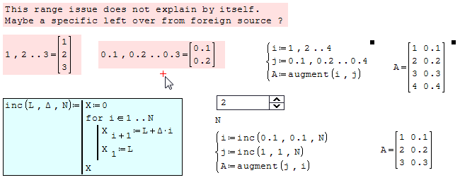

#1 Опубликовано: 12.11.2018 05:37:38
Hi. Is that ok?
range_issue.sm (2,74 КиБ) скачан 1314 раз(а).

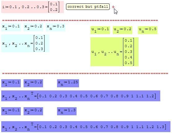

#3 Опубликовано: 12.11.2018 13:34:39
Is that ok ?[/quote
... doctored otherwise from undefined 'zero' in Smath.
rangeissueDoctored.PNG]
#4 Опубликовано: 12.11.2018 20:48:51
Second argument isn't guaranteed in results, as reported in the function description. The reason (as shown by Jean) is that the calculated increment value and/or the results might introduce a small error. We might see if can be somehow improved, though.
frapuano 13.11.2018 06:34:00
#5 Опубликовано: 13.11.2018 01:57:27
Thanks Davide ... Reconciliation as demonstrated.
