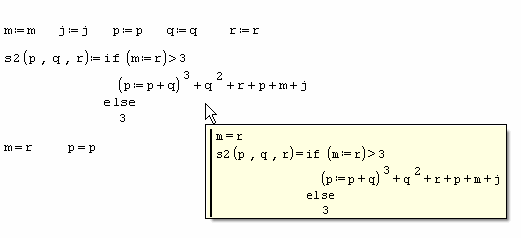

Now here is the first attempt to challenge your explanation for the line function:
I understood that local definitions of names that exist globally will only affect the global variable if that name appears in the last line of the line function.
In the attached example, the global name b is assigned to in the line block but not used in the last line. Still the global value is changed. I see a contradiction between my understanding of your explanation and my observation of what SMath does.
Due to operator ambiguity (please, Andrey, give us back the -> ) I have to mention that all evaluations are set to numeric by default. BTW that is a field of broad discussion in the forum, still with lack of thorough insight (at least by me).
Best regards, Martin Kraska

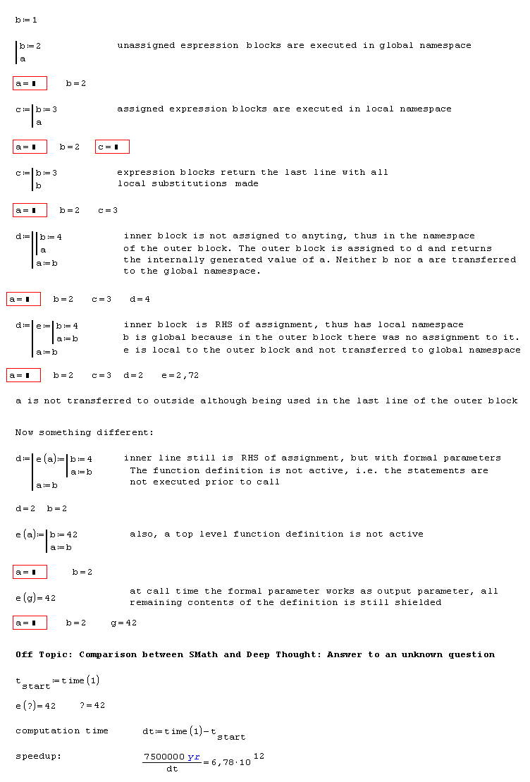

Here are some tests with the last line of blocks being assignments. Seems that in local namespaces these assignments are ignored and the block just returns the RHS of that assignment. Thus the assignment target is not transferred to outer namespace even if it explicitely appears in the last line of the block.
Also, for me it looks like that function definitions are inactive as long as the function is not called.
I might not have been complete in my explanation of the last line of the line function's behavior and therefore must clarify its behavior to remove any unresolved confusion. The last line funnels an expression, not to the general global environment, but to the LHS of an assignment operator in which the line function is the RHS. In your examples 4 and 5 you express a := b. The value of local variable b (not local b itself, nor the value of global variable b, nor global b itself) transfers to the global d. This is correct behavior as intended by the design of the line function in smath. The assignment to a in the last line is treated the same as in any other line in the line function and is therefore a simple assignment to local a, not global a. This again is correct, intended, and consistent behavior.
As you pointed out previously, a free floating line function does not have local variables, so the above behavior does not apply.
In all your examples 1-5, the behavior of the line function is correctly predicted by the rules we have learned from our prior experiences and our recent observations of its free floating use cases.
In examples 6 and 7, the functions d and e(a) are fully and completely defined by a line function on the RHS. If there is activity inside the line functions, it is all executed on local variables and cannot be ascertained by interrogation in the global environment. If we had the ability to use -> or = within the line function environment and have the calculated values show up from within the line function, we could tell. In the end, it doesn't really matter if they are active locally or not. What matters is the global effect. The effect on the global environment is what we must be able to detect and understand. Coming from within a line function that completely makes up the RHS of a function definition, the behaviors of examples 6 and 7 in terms of the effect on the global environment are exactly what we expect.
Function definitions in general do not necessarily contain line functions. Without that shroud, the operations taking place within the function definition are active in the global environment, are subject to the context of activity and variable substitutions prior to the definition, and effect activity and substitutions coming subsequent to the definition. Functions may be complex and contain parts that are globally active and other parts hidden by line functions. But the rules apply consistently to the individual pieces and make a predictable whole. I failed to mention this in my previous explanation.
As for your example 8. Finally, somebody has seen the face of god and brought the answer to the nature of the universe back to us mere mortals. With the mystery now unveiled, the stars will burn out one by one, eventually leaving a dark and physically lifeless, but fully spiritual universal existence in its wake.

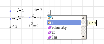

- why is the imaginary unit i still defined even if I use i as loop counter? Didn't I then redefine the symbol?
ok, let's leave the remainder for next x-mas.

imaginary unit - don't know full explanation. In your for loop, the i is a local variable and does not exist as a global variable, therefore, it cannot supersede the default imaginary number i. When global i is assigned anything other than the imaginary i in the global environment, the i becomes a global variable of a new type and the new definition of i with the new type that goes with it does supersede the default imaginary unit i.

Now consider a more advanced function:
m->m, j->j, p->p, q->q, r->r
s2(p,q,r) := †if (m:=†r)>3, (p:=†q+p)^3+q^2+r+p+m+j, else 3
m->r, p->q+p
dynamic assist shows the function defined as s2(p,q,r)->if (r>3), 2*r+p+j+(p+q)^3+q^2, else 3
Here, from the definition provided, smath performs several operations. The embedded global assignments occur for m and for p which take effect in the global environment subsequent to the definition. See from the formula how smath constructs the function and it has been stripped of these assignments. These global assignments occur only during the definition of the function and are not carried out during any call to the function. Any algebraic and/or numerical simplifications and optimizations that smath is able to do in advance for the function occurs immediately when it parses and reconstructs the formula in the definition. These are all part of the active definition feature of smath. Recap: each assignment occurs in two ways. The assignment is interpreted as a global operation with global variables and values. Global operations occur only during definition of formula and not in subsequent calls to the function. Each assignment is also interpreted as a local operation with local variables and values; their effect (and any other possible optimizations) on the formula expression is applied immediately by smath during formula definition. The algorithm for making local substitutions is basically sequential in order of their appearance in the definition syntax and applied to subsequent instances of the variable to be substituted in the formula definition. This algorithm in smath is flawed if circular assignment definitions are attempted.
A circular example for you to play with:
s2(p,q,r) := †if (q:=†r+p)>3, (p:=†p+q)^3+q^2+r+p+m+j, else p:=3
p->6+r, q->6+2*r, r->r
dynamic assistance shows: s2(p,q,r) := †if (6+2*r)>3, 3+r+m+j+(6+r)^3+(3+r)^2, else 3

#15 Posted: 12/16/2012 10:59:02 AM
1,362 likes in 2,276 posts.
Thank you again for the interesting contribution. Responding to all of the aspects will take some time, therefore I just take some of them.
In your for loop/trace example, the i is a local variable and no parameter argument is supplied to occupy local variable n, so the loop cannot execute in the definition. In fact, smath goes further and makes it a syntax error if a numerical value is directly used in the for loop range in this example of a function definition (this syntax error does not occur if the for loop is free floating, but only when it is in the RHS of an assignment operator).
If the formal argument n has a value or not does not affect the definition. You see that in the first section of the attached example. Still the loop is only executed if the function is called.
Thanks for explaining the term "active definition". My understanding is now: "A definition is active if embedded assignment operations are executed at definition time". Correct?
BTW, I never would have guessed that "for" or perhaps also other flow control structures create their own name space. At least, the iterator variable is local as long as it is not used in embedded assignments. To my taste this is one more time too much implicit scoping in SMath.
However, its different modes (numeric, symbolic), myriad structures (function definitions, line functions, for loops, etc), myriad operators (->, :=, +, -, ^, etc) make the set of rules complex and the effort to reverse engineer protracted.
Perhaps we have to add also differences in the program versions, as I fail in reproducing some of your observations.
symbolic evaluation - do you mean what are the rules for substitution to construct formulas that are defined or how does it do algebraic manipulations to simplify expressions?
Worst of all is the lack of the -> operator in recent SMath versions. The operator is available but is displayed as "=". Thus you cannot judge the evaluation mode by just looking at the doc. There have been discussions on what the effects of symbolic/numeric settings for functions at definition time and at call time are. Our recent discussion has really shed some light on that as well, might be worth revisiting those old examples.

Imaginary number:
- imaginary i is reserved and smath confuses itself as explained below
- if reassigned in global environment i := 5, smath redefines i as integer 5 thereafter in the sheet correctly
- dynamic assistance will show as imaginary anywhere on the sheet before the reassignment and i -> 5 afterwards
- if used as an index in a free floating for loop (with no global reassignment prior), i will be reassigned properly
- HOWEVER, the dynamic assistance shows that if the for loop is RHS of an assignment, i is MISHANDLED
- i is not reassigned after function definition, this is correct
- i should be reassigned after function call is executed and this works correctly
- BUG: any i typed in anywhere on the sheet before or after for loop call is assumed by smath to be imaginary
- sometimes, doing so can cause other i's present after the function call to revert to imaginary
- sometimes moving an expression i-> will cause all i's after function call to revert to imaginary
- this only occurs when the change triggers smath to recalculate
- but only when smath forgets to recalculate the function call when it recalculates
- maybe smath is only recalculating below the i-> and if i-> is below the function call, the call isn't recalculated
- when the page is recalculated, the for loop's reassignment takes over again for all i's present after the for loop
- the for loop may not be the only example of this behavior and we should identify where it occurs
- BUG: is smath only sometimes recalculated and if so, why and why not?
- is function call sometimes not included, if so, why and why not?
- is this behavior a bug or feature?
- what are the rules for recalculation and what should I look for to make sure those rules are being properly followed?
#18 Posted: 12/17/2012 9:14:46 AM
kilele
kilele
134 likes in 397 posts.
suggestion: use the unicode i with macron
ī:=sqrt(-1)
After this assignment Smath suggests ī whenever the user presses i
#19 Posted: 12/17/2012 10:48:06 AM
Rising Eagle,
Thank you again for sharing the results of your reverse engineering research. The length of the posts in this topic seem to follow an exponential law. I am asking myself if we are not in a situation where we use SMath to solve problems that we would not have without it.
For me, the right balance between joy and frustration is controled by how deep one digs. Therefore I try to be pragmatic and just limit the search to structures and procedures that we definitly would have a benefit from, should they work reliably.
Things like embedding assignments whereever SMath fails to complain, are beyond what I want to practice and teach. I admit that such experiments are good challenges for assumed rules, but I would try to limit the use cases.
Top level requirement is that things should look and work like handwritten formulas and algorithms on paper. So what are the expectations to handwritten code?
- Variable scoping should be controlled by entities like function or procedures with well defined input and output rules.
- flow control statements like while, if, for, line shpuld not interfere with variable scoping.
- Visual representation and internal handling must allow to tell imaginary unit from variable i. A math program should allow for safe use of i as variable in loops without spoiling complex calculus.
- Everything must be unambiguous, such that you can reproduce everything from printout. An example is the difference between name indices and adress indices. These can be identified by the amount of space. This is not always (never, so to say) obvious to the uninitiated but safe once explained. We had more serious issues with sums and their arguments.
Some of these expectations are still not possible to meet. Others are possible to meet by choice of the autor of the sheet. Best case is where SMath enforces the sheets to meet these expectations by complaining in case of non-safe usage (this sometimes happens in matlab).
The final result of reverse engineering should be a minimal set of survival rules. Examples:
"Never use i as variable name"
"Never use symbolic optimization"
"Never use 3D diagrams"
"Never rely on local scope of variables"
"If in doubt (or better always) press the re-calculate button"
"If the formula could be misunderstood, set braces, even if SMath does not require this"
"Never embed assignment operations except in the body of control statements"
The better the program becomes the less such rules are required.
ī:=sqrt(-1)
This is good information. Once the preassigned value of a default symbol is assigned on the smath sheet to another symbol, the default symbol can be reassigned in any other way and used as desired. Definitely good to know.
I have an alternative to your suggested reassignment: i is the imaginary unit. As a unit, it should be treated as such and assigned to a blue character. Just type:
'i := i
