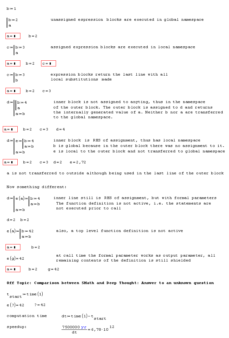

Here are some tests with the last line of blocks being assignments. Seems that in local namespaces these assignments are ignored and the block just returns the RHS of that assignment. Thus the assignment target is not transferred to outer namespace even if it explicitely appears in the last line of the block.
Also, for me it looks like that function definitions are inactive as long as the function is not called.
I might not have been complete in my explanation of the last line of the line function's behavior and therefore must clarify its behavior to remove any unresolved confusion. The last line funnels an expression, not to the general global environment, but to the LHS of an assignment operator in which the line function is the RHS. In your examples 4 and 5 you express a := b. The value of local variable b (not local b itself, nor the value of global variable b, nor global b itself) transfers to the global d. This is correct behavior as intended by the design of the line function in smath. The assignment to a in the last line is treated the same as in any other line in the line function and is therefore a simple assignment to local a, not global a. This again is correct, intended, and consistent behavior.
As you pointed out previously, a free floating line function does not have local variables, so the above behavior does not apply.
In all your examples 1-5, the behavior of the line function is correctly predicted by the rules we have learned from our prior experiences and our recent observations of its free floating use cases.
In examples 6 and 7, the functions d and e(a) are fully and completely defined by a line function on the RHS. If there is activity inside the line functions, it is all executed on local variables and cannot be ascertained by interrogation in the global environment. If we had the ability to use -> or = within the line function environment and have the calculated values show up from within the line function, we could tell. In the end, it doesn't really matter if they are active locally or not. What matters is the global effect. The effect on the global environment is what we must be able to detect and understand. Coming from within a line function that completely makes up the RHS of a function definition, the behaviors of examples 6 and 7 in terms of the effect on the global environment are exactly what we expect.
Function definitions in general do not necessarily contain line functions. Without that shroud, the operations taking place within the function definition are active in the global environment, are subject to the context of activity and variable substitutions prior to the definition, and effect activity and substitutions coming subsequent to the definition. Functions may be complex and contain parts that are globally active and other parts hidden by line functions. But the rules apply consistently to the individual pieces and make a predictable whole. I failed to mention this in my previous explanation.
As for your example 8. Finally, somebody has seen the face of god and brought the answer to the nature of the universe back to us mere mortals. With the mystery now unveiled, the stars will burn out one by one, eventually leaving a dark and physically lifeless, but fully spiritual universal existence in its wake.

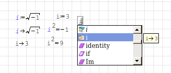

- why is the imaginary unit i still defined even if I use i as loop counter? Didn't I then redefine the symbol?

imaginary unit - don't know full explanation. In your for loop, the i is a local variable and does not exist as a global variable, therefore, it cannot supersede the default imaginary number i. When global i is assigned anything other than the imaginary i in the global environment, the i becomes a global variable of a new type and the new definition of i with the new type that goes with it does supersede the default imaginary unit i.

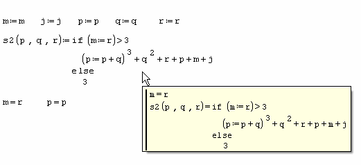

I mean active in the sense that if you embed assignments, e.g., f(x) := (m := x)^2 +1, then the global variable m is assigned the symbolic substitution of global x which shows up subsequent to the definition. The formula, on the other hand, uses the local value supplied by the function argument parameter (into a local variable x) from the function call. Consider:
m->m, x->x
f(x) := (m := x)^2 + 1
m->x, x->x
see how the embedded assignment assigned global x to global m and this is just the definition. Also
m->m, x->22
m->22, x->22
again see the global assignment, even though the function has never been called. This is what I mean by active definition. The evaluation of x^2+1 cannot, of course, be evaluated numerically since there is no value for the local x substituted in with a function definition. Evaluation only occurs when parameter is supplied in a call to f(x).
A subtlety here is that when smath parses the definition, it recognizes the global assignment instruction and that it is independent of the formula and takes the action right away and removes it from the formula used to calculate f(x) when f(x) is called subsequently so that the global assignment is never called again.
m:=4, x:=15
f(3)=10
m:=4, x:=15
In your for loop/trace example, the i is a local variable and no parameter argument is supplied to occupy local variable n, so the loop cannot execute in the definition. In fact, smath goes further and makes it a syntax error if a numerical value is directly used in the for loop range in this example of a function definition (this syntax error does not occur if the for loop is free floating, but only when it is in the RHS of an assignment operator).
Now consider a more advanced function:
m->m, j->j, p->p, q->q, r->r
s2(p,q,r) := †if (m:=†r)>3, (p:=†q+p)^3+q^2+r+p+m+j, else 3
m->r, p->q+p
dynamic assist shows the function defined as s2(p,q,r)->if (r>3), 2*r+p+j+(p+q)^3+q^2, else 3
Here, from the definition provided, smath performs several operations. The embedded global assignments occur for m and for p which take effect in the global environment subsequent to the definition. See from the formula how smath constructs the function and it has been stripped of these assignments. These global assignments occur only during the definition of the function and are not carried out during any call to the function. Any algebraic and/or numerical simplifications and optimizations that smath is able to do in advance for the function occurs immediately when it parses and reconstructs the formula in the definition. These are all part of the active definition feature of smath. Recap: each assignment occurs in two ways. The assignment is interpreted as a global operation with global variables and values. Global operations occur only during definition of formula and not in subsequent calls to the function. Each assignment is also interpreted as a local operation with local variables and values; their effect (and any other possible optimizations) on the formula expression is applied immediately by smath during formula definition. The algorithm for making local substitutions is basically sequential in order of their appearance in the definition syntax and applied to subsequent instances of the variable to be substituted in the formula definition. This algorithm in smath is flawed if circular assignment definitions are attempted.
m->r, p->q+p
Thank you again for these posts and your patience to follow all these issues. Martin (mkraska) and others pointed out our frustration by not understanding how all these things actually work.

Imaginary number:
- imaginary i is reserved and smath confuses itself as explained below
- if reassigned in global environment i := 5, smath redefines i as integer 5 thereafter in the sheet correctly
- dynamic assistance will show as imaginary anywhere on the sheet before the reassignment and i -> 5 afterwards
- if used as an index in a free floating for loop (with no global reassignment prior), i will be reassigned properly
- HOWEVER, the dynamic assistance shows that if the for loop is RHS of an assignment, i is MISHANDLED
- i is not reassigned after function definition, this is correct
- i should be reassigned after function call is executed and this works correctly
- BUG: any i typed in anywhere on the sheet before or after for loop call is assumed by smath to be imaginary
- sometimes, doing so can cause other i's present after the function call to revert to imaginary
- sometimes moving an expression i-> will cause all i's after function call to revert to imaginary
- this only occurs when the change triggers smath to recalculate
- but only when smath forgets to recalculate the function call when it recalculates
- maybe smath is only recalculating below the i-> and if i-> is below the function call, the call isn't recalculated
- when the page is recalculated, the for loop's reassignment takes over again for all i's present after the for loop
- the for loop may not be the only example of this behavior and we should identify where it occurs
- BUG: is smath only sometimes recalculated and if so, why and why not?
- is function call sometimes not included, if so, why and why not?
- is this behavior a bug or feature?
- what are the rules for recalculation and what should I look for to make sure those rules are being properly followed?

kilele
kilele
suggestion: use the unicode i with macron
ī:=sqrt(-1)
After this assignment Smath suggests ī whenever the user presses i
ī:=sqrt(-1)
This is good information. Once the preassigned value of a default symbol is assigned on the smath sheet to another symbol, the default symbol can be reassigned in any other way and used as desired. Definitely good to know.
I have an alternative to your suggested reassignment: i is the imaginary unit. As a unit, it should be treated as such and assigned to a blue character. Just type:
'i := i
PS - I would like to use italics. I could use a cut and paste from a character map, but I would rather use a ctl-key that works in the same way the ctl-g key transforms a roman letter to a greek letter. If anyone knows how, please reply. It's interesting, the blue i shows up in DA as an italic, but as a regular roman character on the smath sheet.
