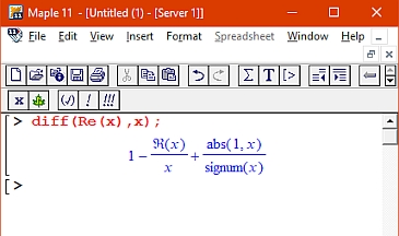

#2 Posted: 5/5/2022 2:07:15 PM
1,138 likes in 1,805 posts.
This is what a slightly newer version of maple thinks about the derivative of the real part of a complex
I assume that neither SMath nor its version of maple can get that, and if they could, handling it numerically might be tricky.
Three possible methods to solve it are attached.
Circle Diagram.sm (249.19 KiB) downloaded 1246 time(s).
