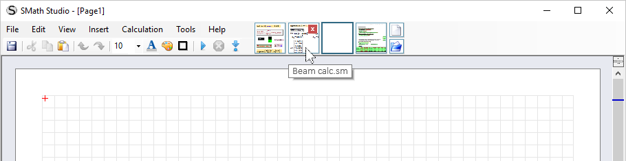

I have an idea to update a UI a bit:
It is just a sketch for now, but the main ideas are:
  1. Simplify work with multiple worksheets;
  2. Refresh SMath Studio UI to make it more modern;
  3. Have SS-117 fixed
Note:
  1. New and Open toolbar items moved to the right against to worksheet thumbnails;
  2. Run/Debug toolbar buttons will be optimized, so the icon for Recalculate button will be changed and it will be shown as Pause during calculation process;
  3. Pages menu item removed from main menu;
  4. MDI interface will be finally deactivated (no windows inside main window will be supported anymore).

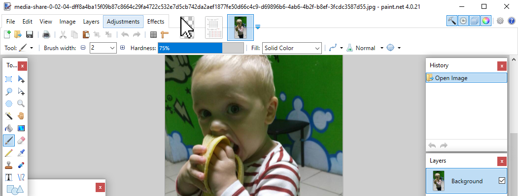

Those who have used Paint.Net will understand where is inspiration taken from.
I think this UI will be convenient for SMath Studio as well. As you can see I do not plan to copy this documents selector, but want to make something inspired by it.

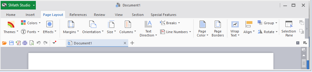

I'd be more into something like in the WPS suite (with ribbons to group menu options, classic tabs for documents, and classic icons just for the main options) but might be matter of taste
(also it could solve some issue that I've encountered trying to integrate an interface for tolbars in plugins - mono has several issues related to toolstrips positioning)
Show Spoiler

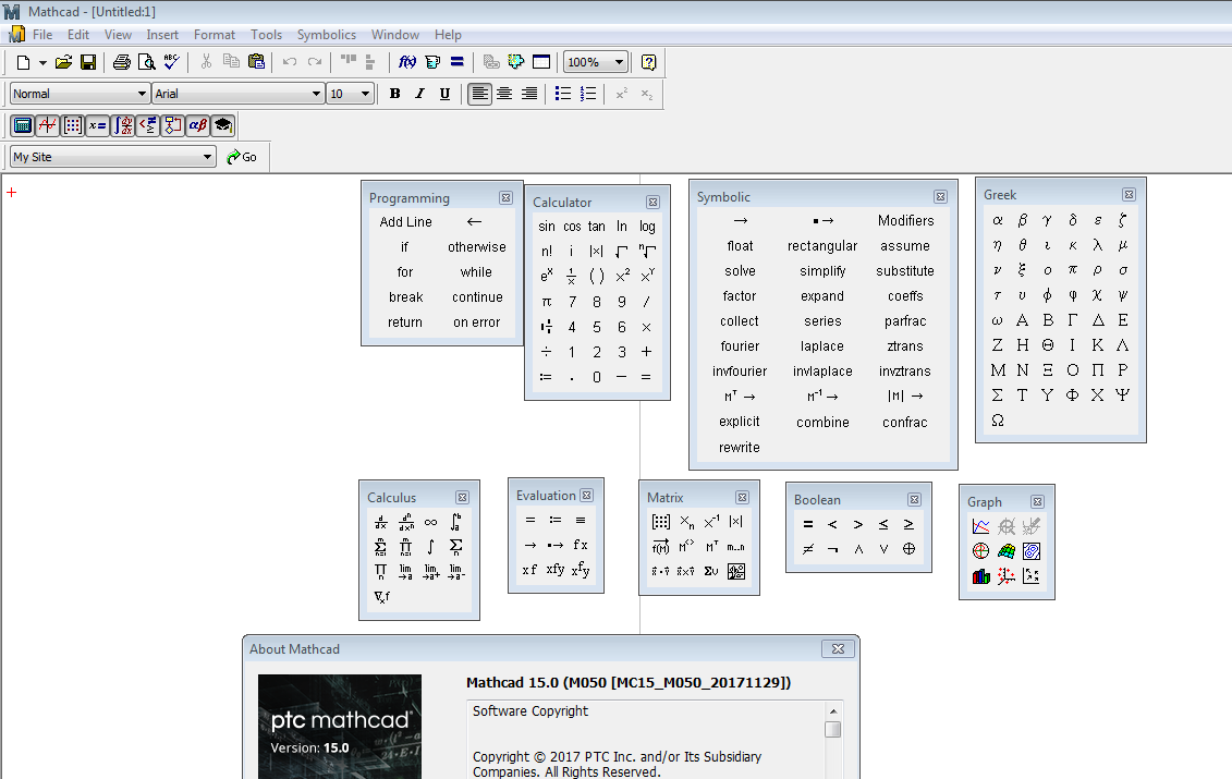

Since SMath is replacing Mathcad for my personal files, but work still uses Mathcad. I do have access to Prime 2.0 (old), but prime is NOT backwards compatible and the company policy is to use version 15 for now. I'm not a fan of the new Word Ribbon that is being emulated everywhere.
The bottom boxes (calculus --> Graph) can be docked into the tool line
