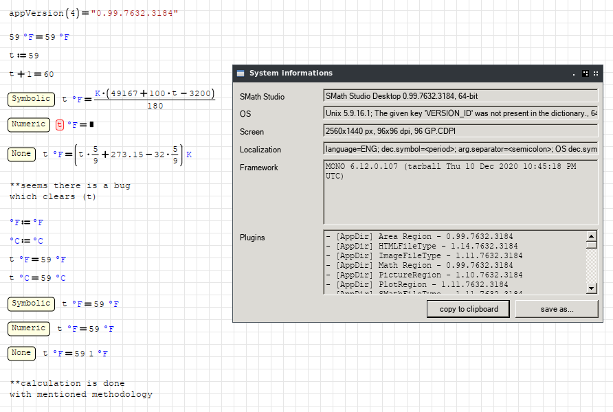

#4 Posted: 12/26/2020 9:20:01 PM
#5 Posted: 12/26/2020 11:59:38 PM

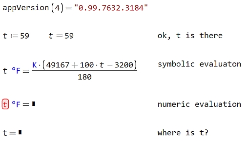

Thanks very much for looking at that Alvaro. I had only tried numeric evaluation- I get the same result as you with symbolic evaluation.
It looks like you are in even worse shape than I am. The variable is still set to the original value for me after attempting to get a Fahrenheit value from it.
