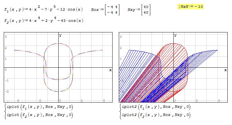

Hi. I'm trying to implement this implicit plot. But can't "cut" the lines in the xy plot. Also, any help about speeding the function is welcome.

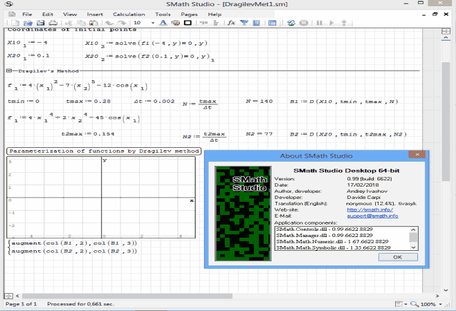

#11 Posted: 2/22/2018 2:45:42 PM
Carlos, Alvaro,
From previous use of Dragilev method, I observed great difficulties
to appropriately start/stop rkfixed. Your example above works fine as is.
For more points with less tentatives in specific cases, the easiest way
is to pass it to the closed shape Hermite suite.
I should revisit some of those examples.
The Esplina AI2000 interpolates as well for closed shapes.

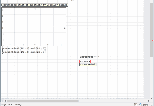

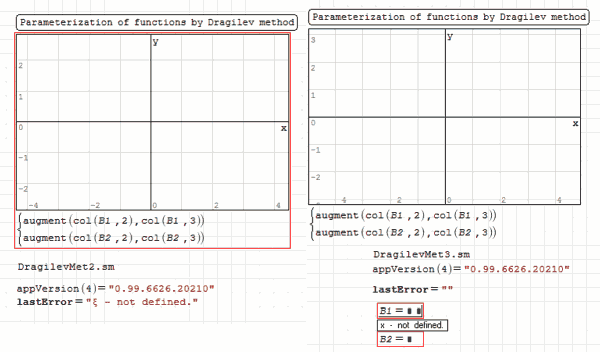

Hola Alvaro, Hello Ber7,
Thanks for your reply, but the DragilevMet2 and 3 files do not work.
The file of Ber 7 does not show any error, but by requiring the value
of B1 and B2, it says that "x" is not defined.
Attached drawing of the errors.

Hola Carlos.
It's because a problem with rkfixed routine in your environment. Try to download this, or use it in the cloud: DM_RK

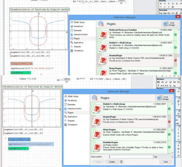

Hola Alvaro:
Gracias por tu respuesta.
Thanks for your answer, but I found the fault.
The interference is caused by the Maxima Plugin,
by disabling it, the file works correctly.
